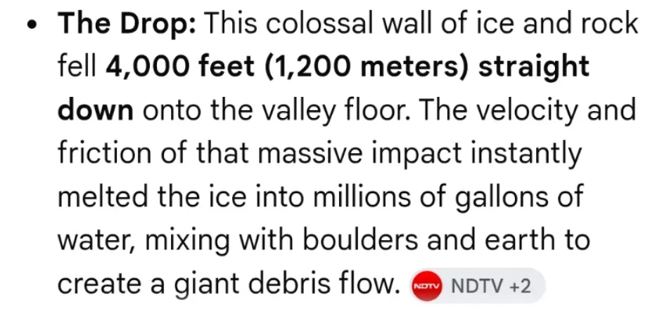

If the mass of the glacier that fell is estimated to be 5 000 000 000 kg from 1200 m then v =153 m/s. And with KE = 1/2 mv^2 . joules at impact= 58x10^9. The phase change from ice to water=334000 joules/kg. So only about 173,653 kg of ice converted to water at impact.256bits said:
Right. I incorrectly used the Cp for change in degree for water, instead of that for ice.Point Conception said:If the mass of the glacier that fell is estimated to be 5 000 000 000 kg from 1200 m then v =153 m/s. And with KE = 1/2 mv^2 . joules at impact= 58x10^9. The phase change from ice to water=334000 joules. So only about 173,653 kg of ice converted to water at impact.
Greg Bernhardt said:The videos are terrifying
https://www.nytimes.com/2026/08/26/world/asia/nepal-flood-glacier-ice-avalanche.html
Unfortunately I think we'll see more of this with glaciers continuing to melt.
Correction the joules at impact with 5000000000 kg ice falling 1200m: KE = 1/2 mv^2 = mgh = 5.8 x 10^13 joules. So with 334000 joules/kg ice to water phase change. About 176 000,000 kg ice converted to water at 0 degrees C at impact. Out of 5000,000,000 kg ice in glacier. *** Of course all this is kind of hand wavy since the glacier contains other material in the total mass . And some of the kinetic energy at impact is going to displace material at impact locationPoint Conception said:If the mass of the glacier that fell is estimated to be 5 000 000 000 kg from 1200 m then v =153 m/s. And with KE = 1/2 mv^2 . joules at impact= 58x10^9. The phase change from ice to water=334000 joules/kg. So only about 173,653 kg of ice converted to water at impact.
