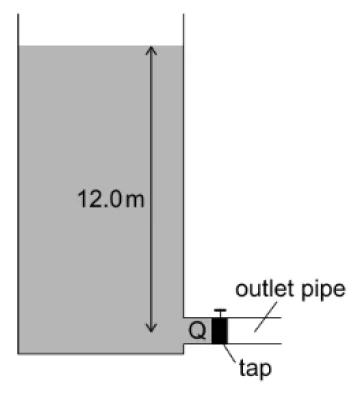

A reservoir has a constant water level as shown in picture below. For each statement, check whether it is true or false
(i) Velocity of the surface water going down is equal to the velocity of the water flowing through the outlet pipe
(ii) If the reservoir is sealed and the water will still be flowing but eventually it will stop.
(iii) If the outlet pipe moving to higher position, the velocity of the water will decrease
(iv) In the picture, pressure at the surface of the water in reservoir is equal to the pressure at the tap
Bernoulli Equation
Continuity Equation
Diagram of a tall water reservoir, shaded grey to a water level marked 12.0 m with a double-headed arrow, with an outlet pipe at the bottom right controlled by a tap labelled Q.
The answer to this question is statements (ii) and (iv) are correct.
(i) This is FALSE because the speed of water in the tap is greater than speed at the water surface
(ii) I don't even understand this statement. What does the "seal" part have to do with water flowing out? Won't the water still flow out through the tap until the tank is empty whether the reservoir is sealed or not?
(iii) In my opinion, this statement would be correct. Increasing the gravitational potential energy of the pipe will reduce its kinetic energy so the speed of water is slower. Why is this statement not correct?
(iv) This is correct because both pressures are atmospheric pressure.
What is the logic to analyze statements (ii) and (iii)?
Thanks
In (ii) I think "sealed" means that the container has a top cover and is no longer open to atmospheric pressure.
Why do you think (iii) is not correct? If the outlet pipe is moved all the way to the top, there will be no water flow. The water below the outlet does not count. The speed at the outlet depends on the height difference from the outlet to the surface.

When the top is sealed, the air above the surface is initially at atmospheric pressure. Will it remain at atmospheric pressure as the level of the water drops? Why do people punch two holes to pour liquid out of a can? (See picture on the right.)

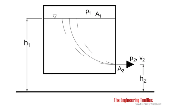

Diagram of a tank with an outlet pipe at its base, showing liquid height h1 above the outlet, surface pressure p1 and area A1 at top, outlet area A2, exit pressure p2 and velocity v2, and height h2 above the ground line.
As the volume of the liquid contained inside the tank decreases, the air pressure above its surfaces also decreases.
"The water will still flow out the tap when it is opened and will stop when the water runs out" only in the case that the tank is not deep enough, and the surface never reaches a critical height that equals the value of the external pressure.
If the tank is deep enough for the surface to reach a certain critical height at which the remaining pressure above the surface + [critical height x liquid density x gravity acceleration], which equals the value of the external pressure, a balance of forces is reached, and the flow stops.
The second one is the case represented by the OP diagram (height differential of 12 meters), because the pressure of one natural atmosphere is more or less equivalent to the pressure exerted by a column of 10 meters of water.

Bernoulli's equation P+ρgh+(1/2)ρv2=const is the logic for analyzing statements (ii) i (iii).
The statement (ii):
P1+ρgh1+(1/2)ρv12=P2+ρgh2+(1/2)ρv22
Is it possible to have the next situation P2-P1=ρgh1-ρgh2=ρgh?
The statement (iii):
P1=P2⇒gh1-gh2=(1/2)v22-(1/2)v12
(1/2)v22>>(1/2)ρv12⇒gh1-gh2≈(1/2)v22

When the level reaches 10 meters, some pressure value may still exist on top of the water, which should be considered.
Besides the weight of the 10-meter column, the tap will be "feeling" that pressure (which is transferred through the incompressible liquid).
Try applying Bernoulli to each side of the tap, please.
Water will stop flowing through that tap when the potential and pressure energies on the left side of the open tap equal the pressure energy on the right side.

I am not sure what you mean by "each side of the tap" but I will take position 1 to be at the 12 m above the tap and position 2 to be at the tap.
Set: ##v_1=0## and ##h_2=0##
$$P_1 + \frac{1}{2} \rho v_{1}^{2}+\rho g h_1=P_2 + \frac{1}{2} \rho v_{2}^{2}+\rho g h_2$$
$$P_1+\rho g h_1=P_{atm}+\frac{1}{2} \rho v_{2}^{2}$$
If ##P_1+\rho g h_1=P_{atm}## then ##v_2## will be zero so the water won't flow eventhough the tap is open.
