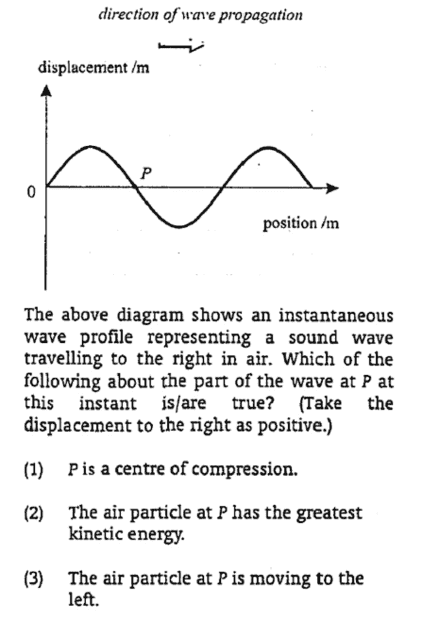

Correct statement about sound wave

Graph of a sinusoidal wave profile of a sound wave travelling to the right, displacement in metres against position in metres, with point P marked where the curve crosses the axis going downward, and an arrow labelled direction of wave propagation above.
My answer is (1) and (2) but the teacher said it is only (1). I thought the speed of point at center of compression and center of rarefaction would be the maximum.
Or the correct one is the speed at center of compression and center of rarefaction would be zero?
Thanks
Your teacher is wrong. Each particle is undergoing SHM and so velocity is the greatest whenever displacement is zero.
