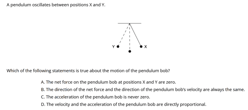

Which one is a correct statement about oscillation?
24 replies · 2K views
songoku
2,514
395
Please see below
Simple Harmonic Motion
##a=-\omega^2 x##
##F=m.a##
The answer is (C), but in my opinion all options are wrong:
(A) is wrong because at X and Y the net force is maximum, not zero
(B) is wrong because the direction of net force can be in opposite direction to velocity
(C) is wrong because at the middle (equilibrium point) the acceleration is zero
(D) is wrong because they are not directly proportional
Why is (C) correct?
Thanks
Be careful. Can a particle have nonzero acceleration at an instant when its speed is not changing?

A pendulum will approximate simple harmonic motion only for small oscillations. The problem statement does not indicate small oscillations. So, you cannot assume the motion is simple harmonic. Nevertheless, you should be able to argue that only (C) is correct.
Reply
You are correct that the net force is not zero at X or Y. (However, for large enough oscillations the net force will not be maximum at these two points.)
Can you explain why the net force can't be zero at X or Y?

A pendulum bob moves continuously along a circular arc between two turning points. Can you provide a simple argument why an object in continuous motion along a curved path must necessarily have non zero acceleration? The argument works for any curved path, not only a circular arc.
This animation from the pendulum Wikipedia article is quite informative. Note the relation between the acceleration and the velocity directions. You can also see that the velocity goes through zero at the turning points. However, the acceleration is never zero.
Something is zero at the lowest point of the motion, but it is not the net force. What quantity (other than the angular displacement ##\theta##) is it?

Ah ok, so that's my mistake.
Since this is not SHM, so the motion of the bob can't be taken as straight horizontal line but will be an arc so I think there will be two accelerations; one is from the restoring force and one is centripetal acceleration
At the middle, the acceleration from restoring force is zero but there is centripetal acceleration so even though the speed is not changing, the acceleration is non zero.

The net force can't be zero at X or Y because there will be restoring force pulling the pendulum back to opposite direction but I don't know why the force is not maximum at X or Y

Take an extreme case where the bob is released with the string horizontal. Use energy conservation to find the speed at the bottom of the swing. Compare the centripetal acceleration at the bottom to the acceleration at X or Y. Compare the net force on the bob at X to the net force at the bottom.

speed at bottom of the swing = ##\sqrt{2gL}## where ##L## is length of pendulum
Net force at bottom = ##T-W## where ##T## is the tension and ##W## is the weight of pendulum bob
Centripetal acceleration at bottom = ##\frac{T-W}{m}##
acceleration at X or Y is due to restoring force. Is restoring force the resultant of tension and weight at this position?

OK. So, what is the centripetal acceleration at the bottom expressed in terms of g?
What is the net force on the bob at the bottom expressed in terms of m and g?
When the bob is at X (where we are taking the string to be horizontal in this case), what is the acceleration of the bob? What is the net force on the bob at X expressed in terms of m and g?
Compare the net force at X with the net force at the bottom. You should see that the net force is not at a maximum at X.
2g
2mg
I suppose it would be g
mg
Yes, the net force actually is bigger at the bottom. Is bottom the position where the force is maximum?

You can show that if the angular amplitude of the swing is greater than ##\tan^{-1}(4/3) \approx 53^\circ##, the maximum force during the oscillation occurs at the bottom of the swing.
For amplitudes less than this, max force occurs at X (or Y).

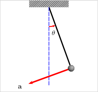

Here's an interactive animation. Click on "Lab" to explore the acceleration for different amplitudes.

If you look at the problem in one dimension (tangential) by discarding the irrelevant constraint force in the radial direction then yes, one could regard the tangential component of gravity as a "restoring force".
Whether radial force or torque from the pendulum arm are truly "irrelevant" may depend on the exact quantity one is trying to determine and the level of detail of the model.
