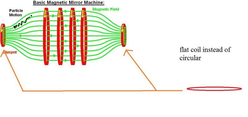

Hello,
Knowing that the loss cone for a symmetrical geometry is also symmetrical, I was thinking has anyone ever tried a magnetic mirror where the central magnets are circular but the end magnets that create the highest B field are instead flattened. Wouldn't a flat coil achieve a stronger B field in the coil center therefore create a better trap? What would happen to the loss cone geometry in such an arrangement ?
Also the plasma density needed for a visible range laser to interact with it is very large into the millions of atmospheres if I calculated correctly , but if the frequency of light is decreased to the lower end of infrared then it seems the plasma density required for the EM radiation to interact with the plasma is much lower , in the couple of hundred atmosphere range.
My second question is this, are there any experiments and research ever done on plugging a magnetic mirror end with focused EM radiation like that of coherent laser light?

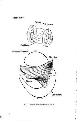

Yes. That's what's done with a baseball coil or with Ioffe bars. This helps a lot. But the results with any magnetic mirror configuration are far inferior to what is being achieved today with toroidal configurations like the tokamak.
That is what MFTF-B at Lawrence Livermore National Lab was meant to explore:
https://en.wikipedia.org/wiki/Mirror_Fusion_Test_Facility
