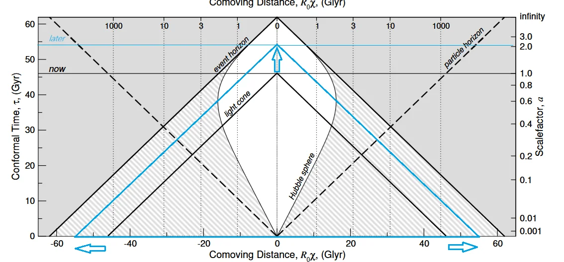

Matterwave said:
What? What event horizon are you talking about?

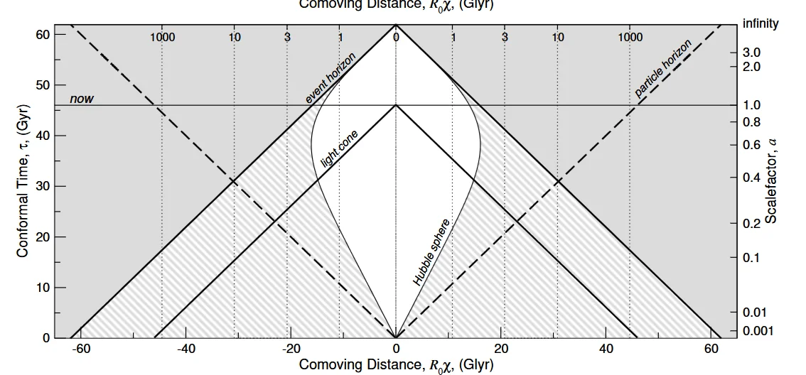

If you compare where the EH intersects the 'now' line with how far the 'light cone' reaches out, then the former is closer than the latter - is what Jamie meant.
Thank you for the graph! It is clear.

The particle horizon is the mirror image of our past light cone. That's the currently observable universe, and what you're focusing on. I don't think there's any disagreement here.
The past light cone, as can be seen on the conformal graph, is bounded by the event horizon, which is the maximum observable region of space time. The particle horizon in the infinite future is the mirror image of the event horizon. Hence this is the in-principle observable universe.

The graphic (and commentary) in post #12 should help.

Jaime Rudas said:
I don't understand what you mean when you say it "is bounded." And I don't understand it because I don't see them coinciding.

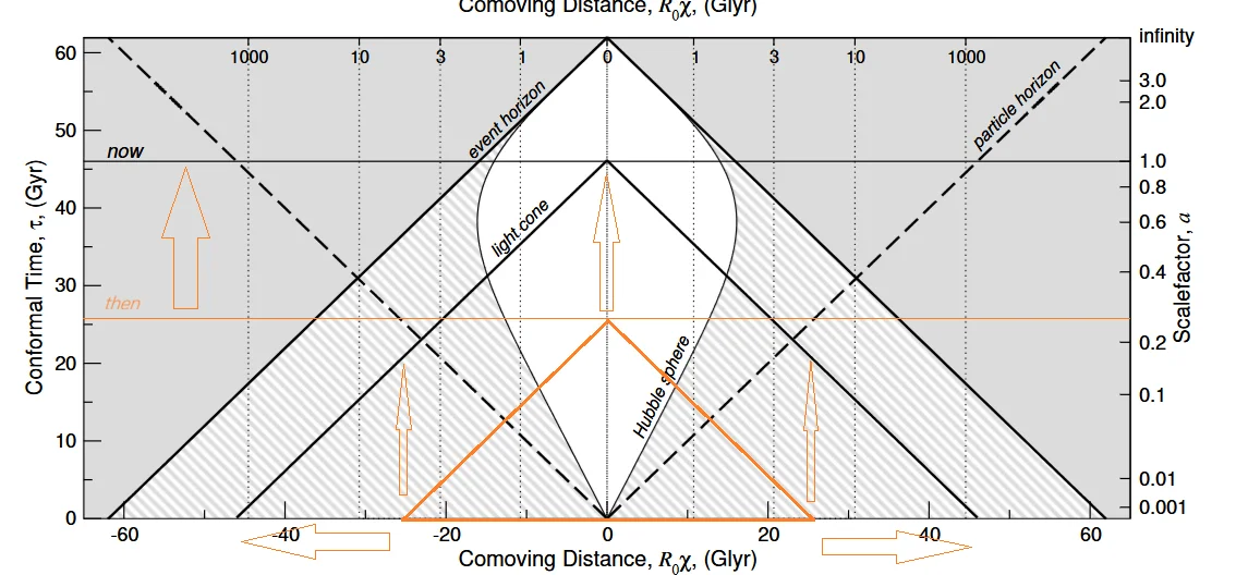

What I mean here is that as time moves forward, each subsequent light cone expands, with its apex moving up along the time axis, and its basis covering more of the distance axis.
Like so
and
The largest possible light cone has the apex at the top of the diagram, in the limit of the infinite future, when the rest of it coincides with the shape of the event horizon.
The entire diagram can be read as a sequence of light cones, raising from t0 to infinity, covering all the events in space-time that have been, are, or will ever be in causal contact with the observer.
All those light cones and the events on them are interior to the area bounded by the event horizon.
The reason I was stressing that the particle horizon is the mirror image of the light cone, was to do away with such seemingly paradoxical statements as in your post 9, which carry the risk of confusion.
There's nothing wrong with looking at the intersection of the PH and the 'now' line and reading the size of the observable universe from it, but that's only because PH is the mirror image of the light cone. Since PH represents outgoing signals instead of incoming, there's no actual real sense in which the events it marks are observable, other than when they intersect with the light cones. It's the latter that determine observability.
So, when we say something to the effect of
'A galaxy currently located 20 billion light-years away lies beyond the event horizon but within our observable universe.'
we aren't actually talking about events marked by the intersection of the PH and the 'now' line, because that's outside the EH, but about events in the past, merely on the same comoving coordinate, which lie on the light cone and inside the EH - just as all the events that can ever, in-principle, be observed.
We all make such statements, which are made acceptable by the semi-persistence of galaxies, as we can sort of assume the hypothetical galaxy in question is still roughly there, in a roughly similar state, as roughly the same entity. So that even as we're not, and never will receive any light from a galaxy on the PH but currently beyond the EH, it still makes some sense to say that we observe 'it'.
But when discussing space-time diagrams and event horizons, I feel, it's best to remember that those are events in space-time we're talking about.
Also, terribly sorry, I seem to have misspelled your name earlier.
