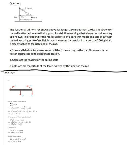

1. Link to problem and the answer I got - https://ibb.co/ncGfDA
2. I got an answer, but I was wondering if this is correct or not? Am I correct to say (in part c) that the vertical component of the hinge's force will be equal to the sum of the vertical forces being exerted in the negative direction?
3. I attempted my answer (hopefully finished) in the link above

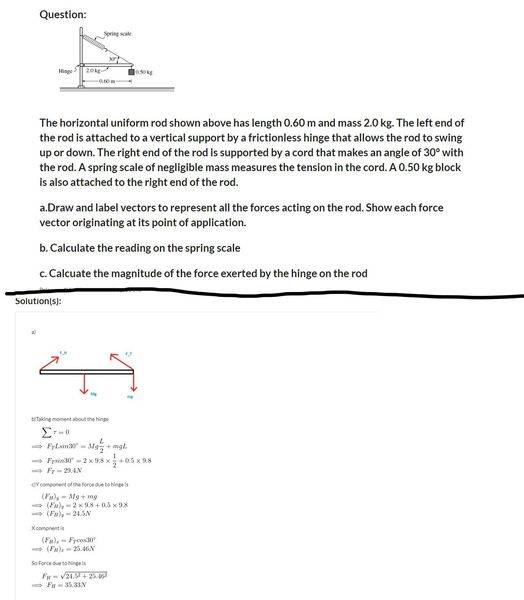

dangerboyy said:
Link to full question and my answer at the bottom of text
Not quite. Wouldn't you need to include the vertical component of FT in your calculation of (FH)y?
That's what I was thinking, but I wasn't exactly sure how to get an answer if I did so. May I request guidance?
The system is in static equilibrium. So, what can you say about ΣFx and ΣFy?
Well, ΣFx and ΣFy must both equal 0 in static equilibrium. How could I separate Fy in the positive direction among the cord and hinge?
edit - a light bulb turned on in my brain - Could I find Fy of the cord, then subtract from the total Fy in the positive direction to find that of the hinge?
You’ve done everything correctly except when you balanced the vertical forces you forgot to include the tension. In exactly the same way you included Ft cos(30) in the horizontal forces add the vertical component into to equation with the vertical forces. It’s just one more term, and you already know the value.
