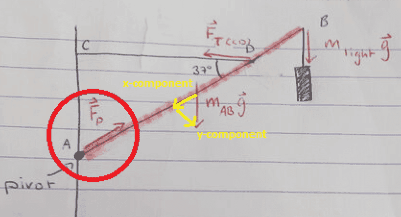

I thought that the force by the pivot A on the pole AB would be the reaction force to the x-component of the gravitational force on AB. This would mean that the force by the pivot would be parallel to the pole, but in my notes from class the force vector seems to be more along the bisector of CÂB..

I highlighted the pole that I was talking about there in pink.

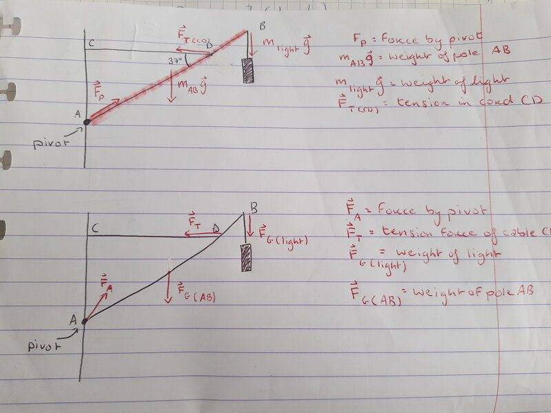

Here are the free body diagrams, the top one is the one that I thought would be right and the bottom one is the one from my class notes (different vectors for the force from A/pivot), I drew the forces acting on the pole (pink) AB.

The thing a pivot cannot do is resist any torque.

Yes, taking the moment (torque) about the pivot gives you an important equation. If the pivot was a solid arm welded to the post, then you wouldn't need the cable BC.

You must be misunderstanding something. There must be zero torque about that pivot point. That's one of your force balancing equations.
Also, because the pivot cannot resist a torque, you need the cable BC to keep the traffic light from crashing to the ground. If there were no pivot and the whole sructure were rigid, you wouldn't need the cable.

Ah, do you mean that I need to use the fact that the net torque must be zero to calculate the tension in the cable? If so, I understood this part. I am confused about how to calculate the force exerted by the pivot onto the pole AB (part b of the question) and why it is not parallel to the pole AB as I have drawn/assumed in this diagram. Is it not a reaction force to the x-component of the weight of AB that is directed at the pivot?
The reaction force at the pivot could be in any direction. Imagine taking hold of that arm AB and pushing or pulling it however you like. The pivot must react to that by Newton's third law. That force is an unknown in your equations.

Aaaah, that makes sense. I see now how it was wrong to think of it as only a reaction to the weight of AB, dang it seems so obvious now :doh:

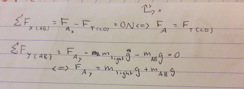

So since the structure here is stable I can assume the net forces on AB in the x and y directions are zero, and then use this together with all the other forces acting on AB to find the the x- and y-components of the force by the pivot? Like this:
Thank you a lot again! And sorry for taking so long to get what you were saying 😅
