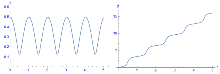

I don't find any problems with small L or Az when R = 0.For L = 1 m and Az = 0.2 kg m2/s I get this behavior

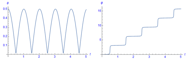

For L = 1 m and Az reduced to 0.02 kg m2/s I get
For these graphs I let ##\theta_0 = 0.5## rad, ##\dot{\theta}_0 = 0##.

I don't find any problems with small L or Az.For L = 1 m and Az = 0.2 kg m2/s I get this behavior
Yep, I looked a bit more closely at the parameter space. If you plot it using cartesian coordinates though, you'll see what I mean. The motion goes from smooth to "jerky" rapidly (The sines and cosines of phi go all over the place due to its "stepping" behaviour as in your graph). But indeed, the simulation doesn't break down.
