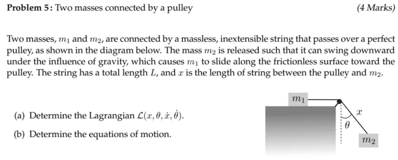

Two masses connected by Pulley - Lagrangian problem
member 731016
Please see below
Please see below
For this problem,

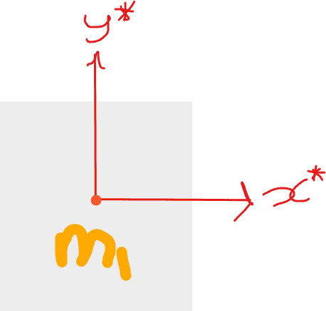

My solution to (a) is,
We have constraint ##x + y = L##. There are many places we could define our (x,y) Cartesian coordinate system. However, the most easiest I think for the problem would be to attach a ##x^*## and ##y^*## coordinate system at the COM of ##m_1##. We define ##\hat x^* > 0## parallel to rightward horizontal and ##\hat y^* > 0## parallel to upwards vertical.
Since the COM of ##m_1## is not moving with respect to our defined coordinate system (orange dot denotes m_1 COM in diagram above), then we omit ##m_1## KE in the Lagrangian form of the system. The ##(x^*, y^*)## coordinates of ##m_2## is ##(x\cos \theta + y, - x\sin \theta) = (x\cos\theta + L - x, -x\sin\theta)##
The velocity coordinates are by definition the time with respect to the linear time ##t## (I think we could generalize this from being with respect to linear time to being with respect to any non-linear, higher dimensional time ##(t', t'', t''', ...)##). However, we assume classical case. Thus ##(\dot x^*, \dot y^*) = (-x\sin \theta \dot \theta + \cos \theta \dot x - \dot x, -x\cos \theta \dot \theta - \dot x \sin \theta) ##
Thus by definition of T and V, Lagrangian is ##\mathcal{L} = \frac{m_2}{2}(x^2\dot \theta^2 + 2\dot x^2 + 2x \dot x \dot \theta \sin \theta - 2 \dot x^2 \cos \theta) + m_2g(x\cos \theta \dot \theta + \dot x \sin \theta)##
However, does anybody please know whether I am correct so far?
Thanks!

The Lagrangian does not have m1 since I chose m1 COM as coordinate system. Not sure what you mean about dimension of PE term sorry.

I don't understand this, please explain. Are you saying that the equations of motion will be the same regardless of the size of ##m_1##? If ##m_1## is that of a battleship, the EOM of ##m_2## will be pretty close to that of a pendulum. If ##m_1## is that of a gnat, the EOM of ##m_2## will be be pretty close to that of a free-falling object..
