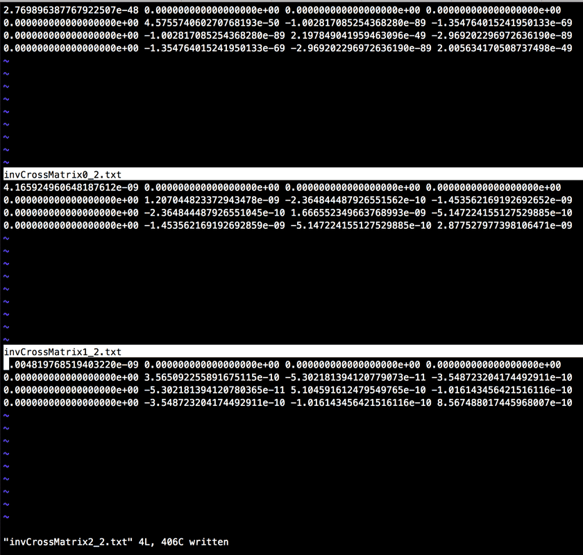

Thanks for your patience, the issue is a little tricky. I have understood what you mean by replacing ##N_a## with a high value (since ##\bar{n} = 0## for different redshift, what you say by "no data").
Doing this, I can sum the 3 inverted covariance matrices (because I consider only 3 populations, with an overlapping between population "2" and population "3".
Below the inverse matrix of the 3 inverted covariance matrices computed for a given redshift bin (bin = 2 = third redshift bin, starting from bin=0) , and from the top to the bottom, I consider respectively "population 0", population "1" and population "2" (which are the only populations I use) :
Terminal output showing three stacked text files, invCrossMatrix0_2.txt, invCrossMatrix1_2.txt and invCrossMatrix2_2.txt, each a 4x4 matrix of very small values in scientific notation with many zero entries.
With this redshift (number of bin = 3), I have initially no data for "population 0" and overlap on redshift between "population 1" and "population 2".
As you indicated it, the contribution of "population 0" is negligible (since I took a highvalue for ##N_{a}## term) : this way, I avoid division by zero (I prefer for the moment in my code doing this but I will delete rows/columns after surely).
QUESTION 1) I wonder if my method is correct, i.e if I can sum the 3 (one per population) inverse matrices (##(C)^{-1}_{xy}## in Martin White paper) : indeed, I know in Fisher formalism that we can sum 2 Fisher matrix of independent variables to get a final Fisher matrix that will allow to have more constraints on parameters when inverting it.
So I would like to know if I can do the same here, knowing there will be negligible terms like above.

1) Yes, you can sum up as many inverse covariance matrices as you want. The fake values are a bit risky, but you can verify the risk by changing them and seeing if that changes your result.
