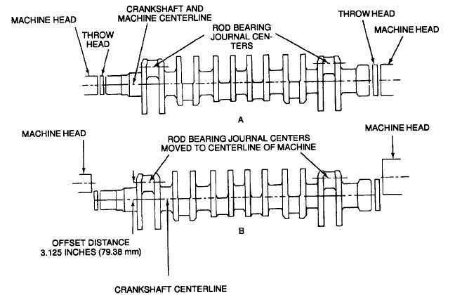

Grinding the crankshaft is a relatively straight-forward process. The crankshaft nose is placed into the head stock chuck and the crankshaft flange (in some cases the crankshaft seal surface) is secured in the tail stock chuck. At which point the main journals can be ground. The rod journals are ground after the machine is set to the proper stroke and after the counter weights are set. After the crankshaft is ground, the oil holes are chamfered and deburred. Then, the crankshaft is polished with a fine grit belt to achieve a satisfactory micro finish.
The above process can be used to add more stroke or remove crankshaft stroke. This has been done for years. The 12 o'clock and 6 o'clock positions are offset ground.
My question is - Is there a benefit to offset grinding the 3 o'clock or 9 o'clock position?
Would there be an advantage regarding timing?
  • Two diagrams of a crankshaft on a grinding machine, labelled A and B: in A the rod journal centres sit on the crankshaft and machine centreline, in B they are moved to the machine centreline with an offset distance of 3.125 inches (79.38 mm).
Not sure I follow. Grinding the pins at 12 and 6 o'clock add/remove stroke; I assume 12 o'clock is pointing back towards TDC? So grinding at 3 or 9 o'clock would change the TDC position with respect to crank angle, and could upset the balance of the engine (as well as buggering up valve timing). So no, no inherent advantage that I see. What were you thinking?

lets just say I am looking for optimum performance with in the limits of a restricted class. Engine limited to stock lift cam shaft, displacement, valve size, compression ration can be changed, stock size piston but weight is open as is any piston rings, ignition must be by engine actuated timing intake and card must be stock appearance, exhaust is open, after market connecting rod is ok. stock size crank
am looking for an advantage...
I am having trouble seeing effect of the 3 oclock offset grind on the crank??
Would this modification make the engine think it had a longer con rod and make more power?
No, it would just alter the TDC position with respect to crank angle. If you did it by the same amount to all cylinders, all you might see is a change in compression ratio.

I've off-set ground to change stroke, (class displacement limit, and get a better R:S ratio) and made the rod journal a lot smaller in the process to use smaller rod bearings.

Just a few tricks.. you can grind cams with a very aggressive ramp rate and actually throw the valves open further than the actual cam lift. Take a look at nascar pistons. If any weight is allowed I would have the smallest area of skirt I could and still hold the piston square. If there is no restriction on compression height you can ofset grind the crank at 12 oclock run a smaller rod bearing and increase the piston height to keep the same compression ratio.
I am not sure I understand exactly what you are asking or the type of engine, but offset grinding the crankshaft away from the cylinder centreline axis, so moving the crank to the side has benefits.
These benefits come in the form of reduced fritional losses. It is possible to alter the con-rod angle at the region of highest pressure so the sideways component of the combustion force which is reacted at the wall is minimized. Piston friction is a big part of the total friction, this is the effect of the piston being forced against the cylinder walls.

I went through the offset crank exercise on paper and concluded that it wasn't worth the effort. Altering the con rod angle will reduce the leverage on the crank at peak pressure and speed up the piston motion, both of which need to be considered.

side pressure and increased piston speed are bad things..but what if the grind is on the opposite side,,Inside of crank journal at three oclock position...won't speed and pressure be reduced?
If the offset is 3 or 9, all that is happening is that the indexing of the crank is changed. That only alters when the piston arrives at TDC compared to the original pin indexing and doesn't change the piston motion at all.
