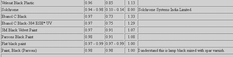

Look up absorbance of lampblack
http://www.solarmirror.com/fom/fom-serve/cache/43.html
Table of solar absorptance values for black paints and coatings, listing Velesat, Solchrome, Ebanol C Black, 3M Black Velvet, Parsons Black and Flat black paint with columns of numeric values.

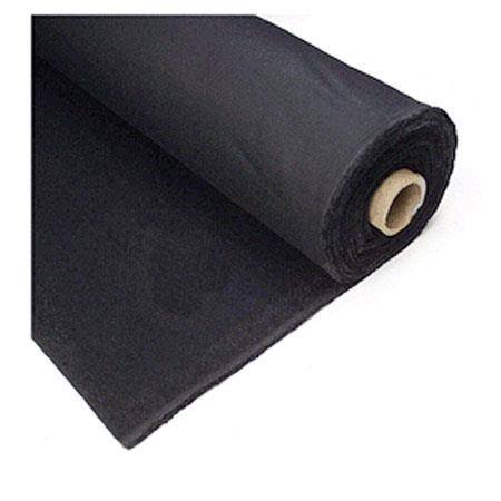

The motion picture industry uses duvetyne for such things. It's relatively cheap, easy to work with, and very very dark.
With proper lighting and exposure duvetyne will pretty easily hide deep in the shadows.
Film, CMOS or CCD sensors all have limited dynamic range -- more limited than the human eye. Even if you are able to make out minor details in a dark area with your eyes, the camera (with appropriate exposure) won't capture those details due to the narrower dynamic range; unwanted details will fall into the shadows.
Roll of black duvetyne fabric unrolled on a surface, with the wound roll on a cardboard core at the top and a flat, matte black section extending toward the viewer.
[The photo above was taken with a higher exposure than would normally be used with this material as the background.]

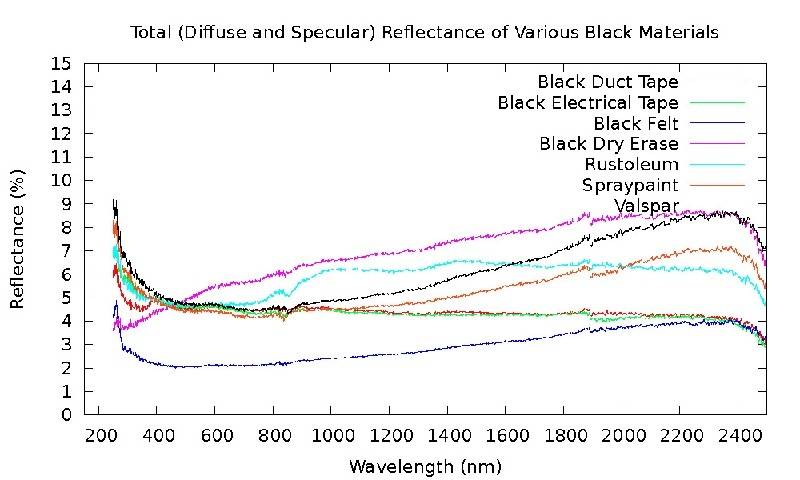

dlgoff said:
. I resized this graph that includes black felt.
Can't quite tell which trace is felt. Bottom one ?
There's some pretty black materials in those links.
It looks like its the bottom one since that trace is not on the original plot.
I guess the source of the felt matters since I have some black felt that can be pretty reflective at certain angles.
Looks like I should check out Edmund Scientific.
