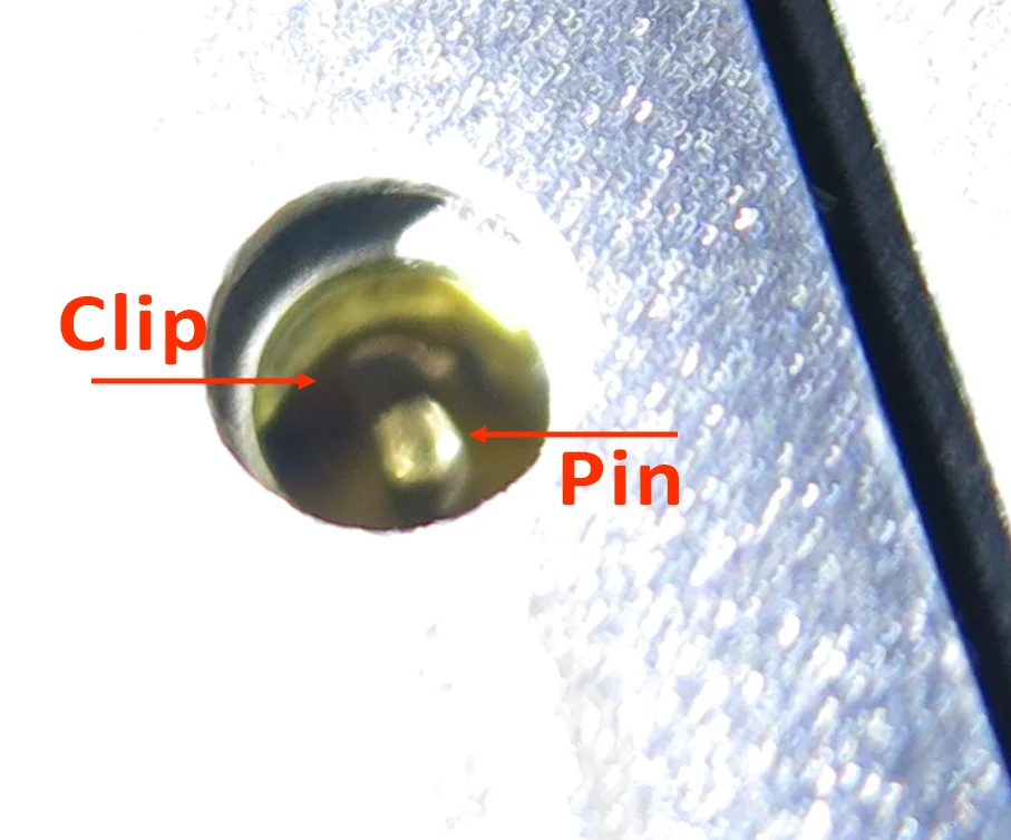

The clip that holds the power connector in the socket has worn down and now connector won't connect.
I am looking for options before sending my laptop away for a week only to have them tell me I need a whole new motherboard.
The little springy clip that holds the connector in the socket seems to have worn down, so it sits against the central pin. When I put the connector in it doesn't push the clip aside, so I can't put the connector in.
Sometimes (10%) I can get the connector in all the way. Sometimes (10% of that) I can get it charging. Even when I do, it charges to about 13% and then just ... stops charging. I don't know why.
So I'm exploring my options before shipping it off for a week and a $1000 repair.

Honestly cracking open the case and soldering off the old connector and putting a new one on would be pretty trivial in all probability. That connector was probably only rated for like 10k connections or something and has given up the ghost, but MB itself is probably still fine.
First crack it open and make sure it isn't gooped with conformal coating or potted and see if you can find a replacement at micro center/online. It's probably through hole mounted too, so it would be super easy and you could most likely even find replacement connector types to upgrade that would fit easily.
If it's gooped I'd just transfer things off and burn it with fire.

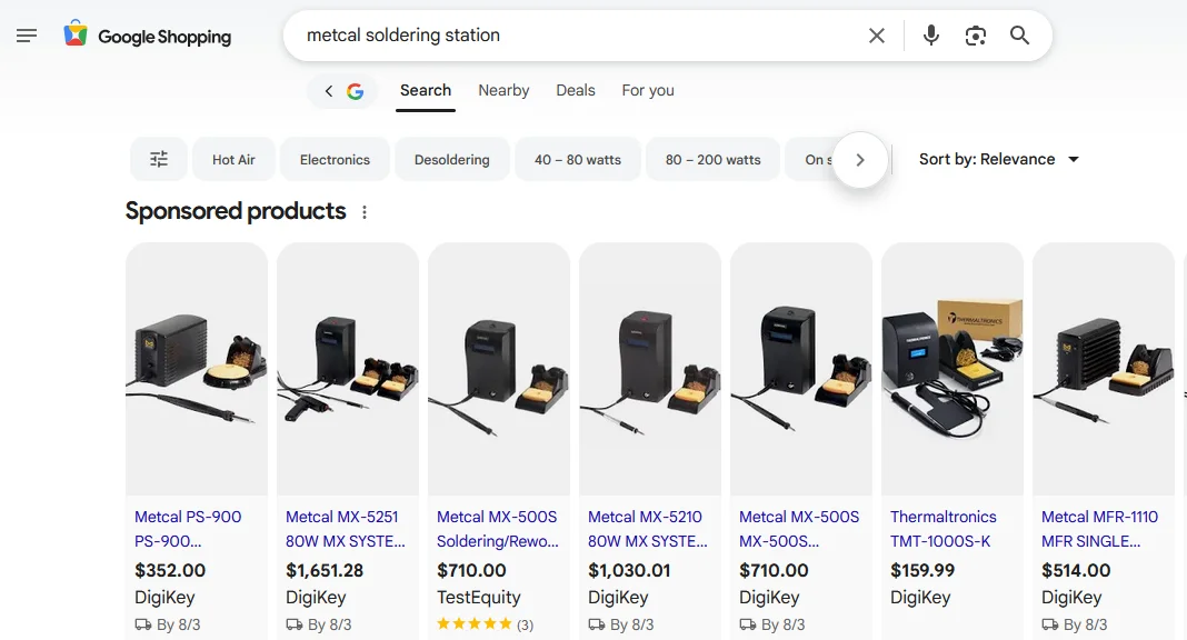

Metcal sounds like a nutrition supplement. That seems off-topic as well as a little personally attack-y.
Sorry, that wasn't my intent. My point is that it can be very hard to do a good job on a modern PCBA without good tools. The "Radio Shack" type of soldering iron that plugs directly into the wall, isn't temperature regulated, and has a big tip that isn't treated well or ever replaced is really not suitable regardless of your skill. Good tools are only common for people that actually do this sort of work more than occasionally. Otherwise, they are a waste of money.
You can absolutely do a DIY repair if you practice a bit and get the right stuff. You can also screw it up if you are unlucky.
LOL Dave. :smile:
BTW, Metcal soldering irons/stations are pricey, so it would be cheaper to replace the laptop instead of investing in a Metcal to try to fix it.

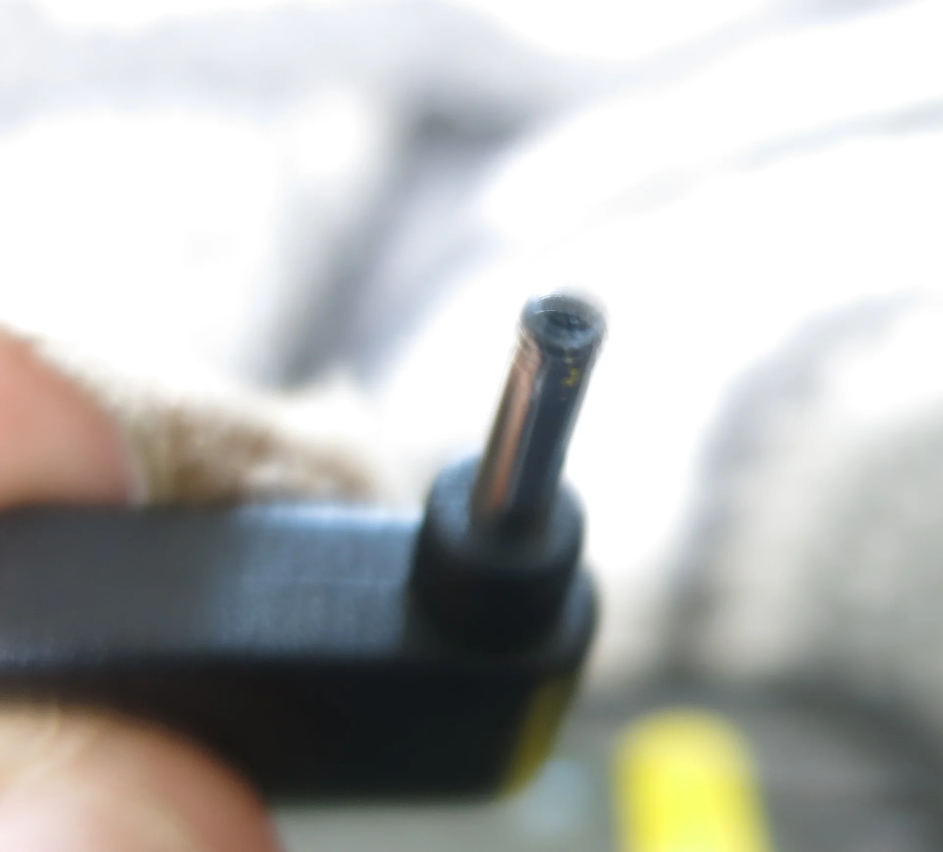

Sounds similar to the problem I had with my 10 year old smart phone.
After a $10 investment for a can of compressed air to blast out a decades worth of compacted dust in the usb-c, with no success, my ultimate solution was to replace just the cord: $10
I suspect that there were two problems, the dust problem, making it harder and harder each year to keep the plug in the phone, which masked the ultimate problem that most, if not all, of the wires at the solid portion of the plug, had broken, and gave intermittent charging success.

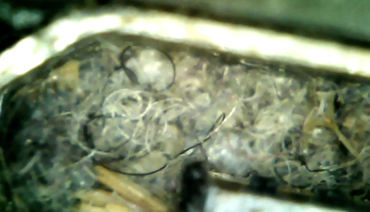

Microscope view of dust collected in my usb-c phone connector:
The solution that worked for me was to use a toothpick to scrape out the dust/lint. It needs to be non-conducting, and ultimately a swordfloss-type toothpick worked the best for me. My USB-C phone charger port now works perfectly again.

I'm more impressed you had the same cord for ten years.

Thanks everybody. A 65W USB-C charger has done the trick. I now have a perpetuitous, non-proprietary solution. Whatever it is that fails on my laptop next, it won't be a power cable problem.
