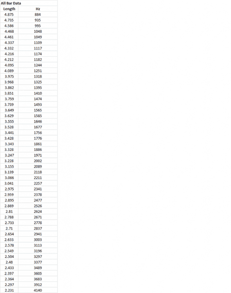

Hello,
I'm creating a musical device which has stainless steel bars cut with a laser cutter. They are all the same length but vary in width. I created a set of test lengths (50 in total) and tested the pitch of each one using a tone analyzer. Now I'm looking to fit a curve to the data so that I can put in any pitch I want and get a length that the bar needs to be to achieve that pitch.
I know that the equation I generate won't be spot-on, but I would like to get as close as possible.
Here's the test data for each bar:
Spreadsheet table titled All Bar Data with columns Length and Hz, listing about 50 bar lengths from 4.875 down to 2.231 paired with frequencies from 884 Hz up to 4140 Hz.

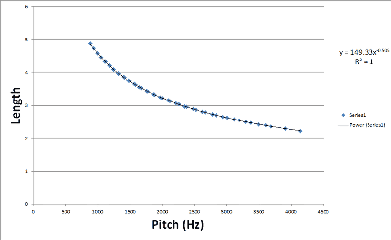

I mapped a "power" curve to the data set:
Scatter plot of bar length against pitch in Hz, with blue diamond points forming a decreasing power curve fitted by a black line; equation y = 149.33x^-0.505, R² = 1.
The curve yielded these results, but there is a significant error in the higher pitches:

If the data is basically transverse vibrations of beams, you would expect the frequencies and lengths to be related by
$$L = \frac{A}{\sqrt f}$$
and your fitted curve is close to that (the exponent is -0.505 not -0.5).
I don't understand what you did to get your final table. Presumably you started from the "desired pitch" and got the "Estim length" somehow, and then converted that length to the "Hz" value using a different formula. But you have only showed us one formula, on your chart ... :confused:

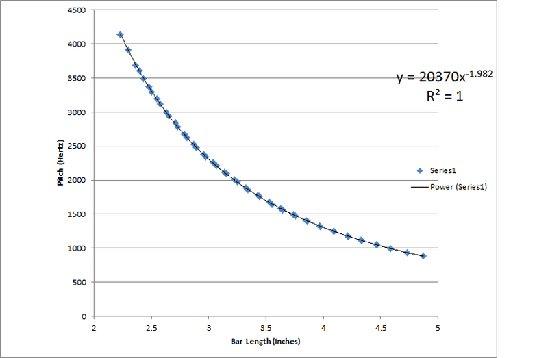

I actually used the formula you posted to derive the lengths for my initial set. I found that the lower pitch bars were spot-on, but pitch error became more pronounced as I tested higher pitched bars. I was hoping that by using a curve fit, I could get even more accurate.
I apologize for not showing the source of the data in the last photo. I plotted Pitch vs. Time instead of Time Vs. Pitch and created another power curve fit. I reversed the data to see what the result would be. This may be erroneous and not a good method of prediction.
Scatter plot with fitted power curve of Pitch (Hertz) against Bar Length (Inches), pitch falling from about 4100 Hz at 2.2 in to about 900 Hz at 4.9 in. Equation shown: y = 20370x^-1.982, R² = 1.
If the data points were exactly on the curve, the two equations you got would be mathematically equivalent. if ##y = ax^b##, then ##x = (1/a)^{1/b}y^{1/b}##.
But your points don't lie exactly on the curve, so when you fitted the two curves you got slightly different results.
There is no obvious reason why the measured data should fit a curve of the form ##y = ax^b## exactly, with b slightly different from = -0.5. If you want to correct the lengths of your bars, it might be better to actually plot the errors, for example plot (measured freq - theoretical freq) against measured freq or maybe ((measured - theoretical)/measured) against measured. Then fit a curve to that graph - not necessarily a power law, maybe a polynomial will fit better.
Then, to get the "real world" frequency you want, you would find the theoretical frequency from that curve, and then the length from your theoretical ##A/\sqrt f## formula.
