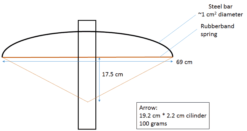

Hi everybody, congrats on this great forum, it was completely new to me.
I am working on this project to measure the physics parameters of crossbows. My father is a member of this guild that uses crossbows for shooting contests. The goal is to shoot small discs from 12 meter high poles with arrows that consist of wooden cilinders (20 cm x 2 cm). The crossbows are often handcrafted and differ quite a lot in shooting speeds.
Last year I built a speed tester and I think that I can use arrow velocity to calculate some crossbow characteristics which would allow some sort of comparison between these handbuild crossbows.
The following parameters would be interesting to calculate and I would really appreciate if you guys would have a look at the calculations.
The following data are available:
Velocity of the arrow (m/s), constant v.
Mass of the arrow is 100 grams, constant m
Tension distance 0.192 m, constant d.
1) Spring constant, k (N/m)
The potential energy of the spring is Up = 1/2 * k * d^2
This is converted to kinetic energy when the spring discharges Uk = 1/2 * m * v^2
The spring constant can be calculated from Up = Uk or
k = m * v^2 / d^2
2) The tension force F (Newton)
Hooke's law states, F = k * d
With k known and d as well, the tension force can be calculated..

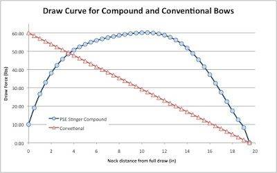

Much of your discussion is predicated on the spring being linear (such as your potential energy expression). Have you ever checked the linearity? I would suggest this as an important thing to check early on, before you invest too much time and effort on a bad assumption.
Good point! I'd thought early-on to recommend he plot out the spring constant versus pull distance, but then latched on to just using the 1/2 k x^2 potential energy number. But I didn't check to see if that still applies if k is a function of x. I'm off to check now... :smile:
EDIT -- Nope, 1/2 k x^2 looks to be the PE only for the linear spring constant case. Good catch!
@ Berkeman - the expression PE = (1/2) k*x^2 comes from integrating k*x over zero to x, which shows exactly why it it tied to linearity.

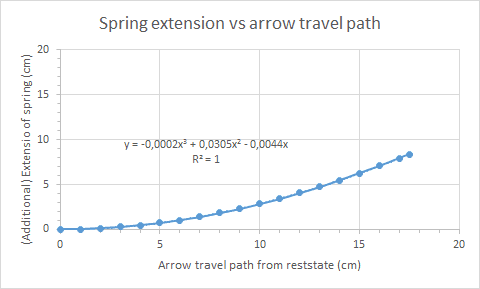

I don't understand the curve Berkeman posted (I'm not sure I am reading the axis labels correctly, for one thing). If this is force versus draw distance, why is the force a max and dropping to zero as the draw increases for the conventional bow? That does not make sense to me.
It looks like the data are plotted so that "x=0" is at the full draw position. For the conventional bow, that is at maximum force. But the compound bow is down to about 10 pounds there.

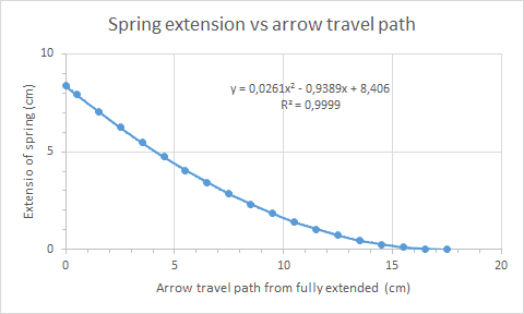

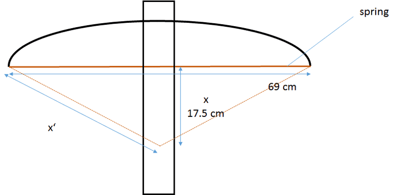

I had another look and I think I can estimate the extension of the propelling spring versus the distance of the arrow acceleration path. I ignore the potentially added effect of the metal bar to which the spring is attached.
It looks like this:
I think that this graph can correct and allow to calculate the spring constant.
k = m * v^2 / d^2 would become k = m * v^2 / (f(0.175))^2 = 0,1 * v^2 / (0.084)^2
I guess it can also be used to calculate the acceleration along the arrow's travel path. Do you perhaps have a hint on how to approach that?
To get an accurate answer to this problem you will need to include the mass dynamic terms in the spring equation .
If you would replace the F = k * x by F = k * x' for the corrected extension, I get to
F = k * x' = m * a. The distance of the spring is 17.5 cm and the acceleration changes with the distance from the reststate.
So d = 1/2 * acceleration * t^2 and acceleration = k * x'(t) / m. I know the speed v of the arrow when it is leaving the spring. Unfortunately I don't know how to continue.

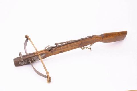

Did you refer to this, Nidum?
A leaf spring which is under load behaves differently depending on how fast the load is released .
At slow release speeds it is just a simple spring .
At high release speeds , as in a crossbow , the spring becomes a complex mechanism where the forces required to accelerate the self mass of the spring become significant . These forces can modify the action of the spring considerably .
Several ways of dealing with this problem theoretically but they are all rather messy for springs with non simple geometry .
Easiest way to get useable answers for cross bow springs like in picture would probably be to use a lumped mass approximation .

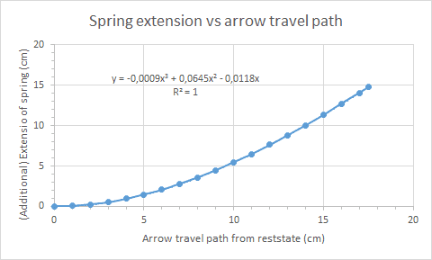

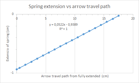

@ Dr D, I was trying to show how I could correct for the fact that the path of the arrow is not the same as the extension of the spring. I calculated for each cm along the path of the arrow, the length of the spring and from that the extension of the spring. As you can see there is a polynomial one can fit to correct. In the graph, the horizontal axis shows the arrow path and the vertical axis the corresponding extension of the spring.

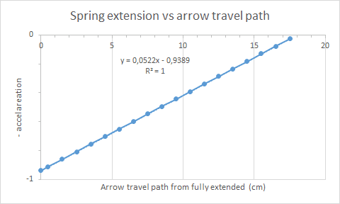

@ Nidum, I was thinking of using F = k * x' = m * a for this. Acceleration would then be a = k * x' / m.
I guess the force in time and with that the acceleration should have the same shape as this graph:
When the spring reaches the rest state, no acceleration is present.
EDIT: I guess x(t) = 1/2 * a * t^2, but I don't know how to do this with a changing acceleration
You need to write down the differential equation and solve it to get the answers that you want analytically .
That would be the following graph
So 17,5 * 0.9389 / 2 ?

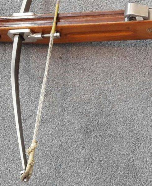

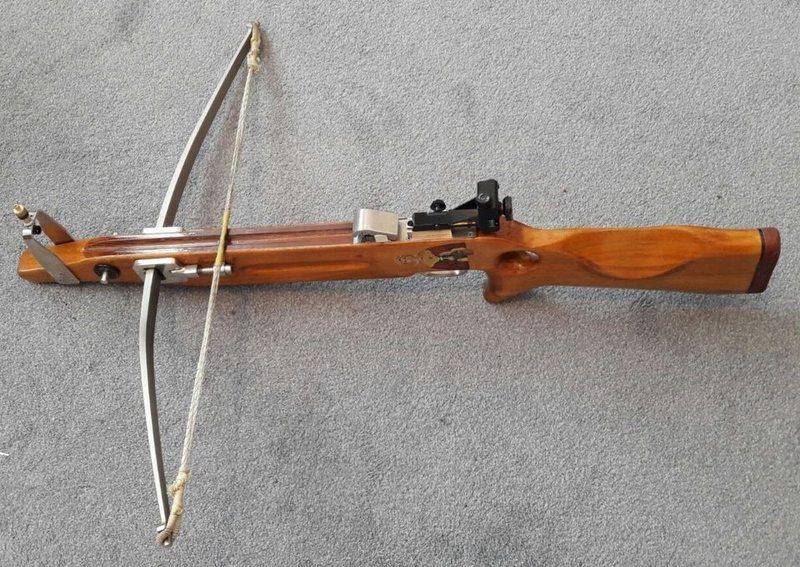

So, this raises a question about the string used. Is the string extensible, or inextensible? My usual assumption is that the string is close to being inextensible, so that the displacement of the midpoint as the arrow is drawn is accommodated only by the bending of the bow. The discussion from the OP seems to indicate that he things the string stretches substantially. Does anybody actually know what happens in this regard?
That's also my take from the description the OP made, and it seems to be what (some of) the graphs seem to represent.
This bit is as clear an indication as any:
Or the fact that the bowstring was labelled as 'spring' in one of the pictures.
But I'm not sure whether this is a mistaken assumption about how the crossbow works - a proper crossbow, either a traditional or a modern one should not have the string stretching more than 1-2%, and all the energy should come from bending of the arms - or whether the crossbow is actually incorporating a stretchy string, which I've only ever seen on toy crossbows that use rubber bands.
Some clarification of what construction is being discussed here would be good to have. What kind of crossbow is it? Are the values given in the graphs provided in posts #13 and #24 measured (i.e., the string does indeed stretch) or are they merely calculated from Pythagoras according to the picture in post #24 (i.e., under the mistaken assumption that the string should stretch)?
To reiterate, if you've got a real crossbows there, then you can't 'ignore the potentially added effect of the metal bar', since that's the only thing that does any work. That metal bar is the 'spring' everyone was referring to in their responses.
What would be more in line with the above would be a graph of pull extension vs force to see how linear that relationship is because it would take into account the deflection effects of the bow (as stated above "the actual spring")
It is indeed a rubberband connected to a 1 square cm metal bar.
