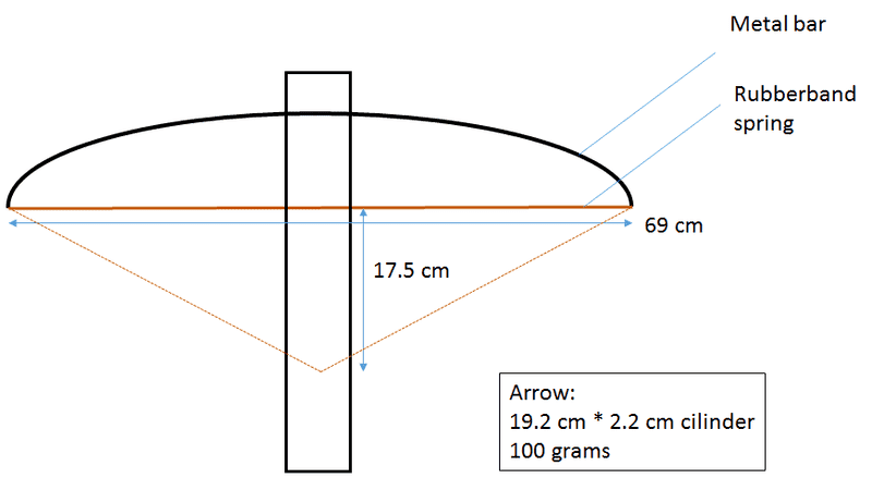

OK - we'll start again . Please post a good drawing of the actual set up . Include detailed dimensions and materials information for the metal bar and for the elastic string .
  • #32
This is the set-up:
I can measure the velocity of the departing arrow. The mass of the rubberband spring is unknown and not practical to measure.
I would be interested to use the velocity and the other known parameters to calculate bow characteristics including the power of the bow.
Let me know if you need more information!

What are the cross sectional shape and dimensions of the rubber band and what material is it made from ?
Alternatively (or in addition) - what extensions of the actual rubber band do you get under different applied loads ?
  • #34
The rubberband has a round shape (rod shape) with a diameter of about 5 mm. I will post a picture of the actual bow later today.
I have no equipment to measure extensions under different loads, so I don't have or can easily collect that information.

Despite the picture, quite some assumptions need to made: no recoil for example.
If you would assume that the propulsion is coming only from a mass less rubber spring, no friction exists, how would you calculate the time it would take for the arrow to cross the 17.5 cm (knowing the final speed)?
How could I approach that?
Thanks for your thoughts!

Since you can measure v (velocity at the arrow separation); and, for an object accelerating from 0 to v, s= 1/2vt, and with s and v then you can determine t (time of acceleration) and subsequently the acceleration a. If of any benefit, from that using F = ma you can determine the average effective bow force. (if, as you specified, you ignore friction and recoil.)
Edit: I just saw thr bow picture and are you sure there is no flexing of the crossbar? If there is as strong a pull force as you state, it is hard for me not to expect flexing in that component.
  • #44
I think s=1/2vt only applies if the acceleration is constant.
  • #45
What this will give you is the average acceleration for the entire travel, not the profile of the acceleration. For for a given succession of values regardless of linearity there exists an average value.
  • #46
OK, I thought it didnt apply. Thats great, thanks a million!
