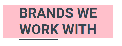

I have a heading with an underline that lines up perfectly so long as the heading occupies only one line. However, when I change the screen width, the heading spreads across two lines. When this happens, the space before the lines of text gets extended and this affects where the underline starts.

width: min-content sort of works, but it makes my heading always take up four lines. I'd like it to always take up the minimum lines possible.
I could use media queries to push the underline further right, but I'd prefer to control the amount of space in front of the lines of text. Is there a way to do this?

I'm no expert, but glancing at the CSS I would expect the (undesired) indent you observe really is centering originating from the text-align: center setting.
It certainly looks like the text is centered, mainly because that is stated in the CSS.
Centering text should be limited to headings, and never applied to body text, as the readability decreases when you try to find the start of the next line every time.
If you set a minimum width and maximum width for the container of the text, you will have a little bit more control over the layout, especially when things get narrow. You have five characters in Brands, and therefore if that is filling a line entirely, you will never get We Work (seven characters) on one line of the same width as Brands with no padding and no minimum width.
And as for the underline, are you sure that is not an <hr> of a fixed width, as there is no underline in the text's CSS, and the underline is clearly not applied to the text. An <hr> is a handy way to separate the end of one block of text from another.
So a bit more of the CSS and the body text is required for us to solve your problem.

  • The second image is in a different font size. I would guess that this is set by a media query applied to the SectionHeading class, which is also probably changing the position of the border, however without knowledge of the styles actually applied to the element this is only guesswork. Learn how to use the Inspect Element tool of your web browser development plugin to see what styles are actually applied to the element. This is something you need to do for yourself, not ask other people to guess what is happening on the basis of incomplete information.

BTW, I am also at a loss as to what effect you're looking to achieve. Is this it?
Regardless, my suggestion is that you take finer control over the layout by tossing out the 'underline' text decoration and rebuild it directly with CSS.

I probably shouldn't have called it an underline. I just wanted something to divide the heading from the section below. I used a pseudo element for the divider, but as mentioned by Dr John below, <hr> could also have done the job.

I should have used <hr> instead of a pseudo element.
Setting max-widths seems to be the trick. It's a lot easier than translating the divider.

Thanks for the link.
Yeah, that's what I was aiming for. The dividing line was moving left to start where the pink area started. Looks like I can fix that with media queries to limit the width of the pink area.
