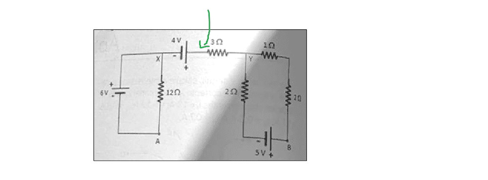

Potential difference between A and B. I just have a doubt. Is the current flowing in the 4V battery null? Yes or not? Why?
U= RI
Imagine that you are an electron leaving the - side of the battery. How would you get to the + side?

Very shortly, considering there aren't any energy storage elements in the circuit.
I'd bet $100 this is is a DC analysis problem. In which case your response is confusing to the student. Not necessarily wrong, but probably not helpful.
You wouldn't. The electrons all go from the + side to the - side.
(I am probably being petty but ...).
And BTW the answer is the non-conservative electric field set up by the emf of the battery which points from - to + and cancels the conservative E field set up by the charge migration which points from + to -.
Again, not helpful to the OP.
edit: Oh, yea, also wrong. Electrons have negative charge and are not attracted to the (relatively) negative potential at the - side. [Curse you, Ben Franklin!]
Actually, we all missed the OP's point and question.
The current in the 4V battery is indeed zero.
Hint: can you find a loop including the 4V battery?

Not all of us. We also didn't give the answer away without dialog or dealing with the question "Why?".
