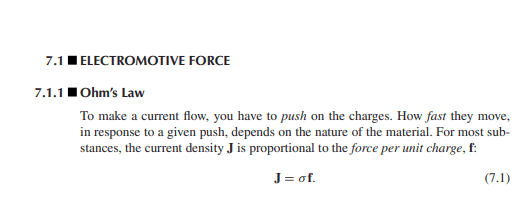

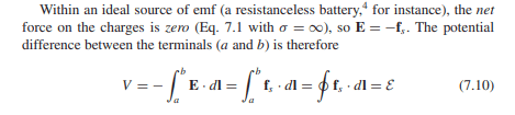

From another point of view we can say that according to Ohm's Law
J = σf where f is the total force including source force and electrostatic force.
In an ideal circuit ρ = 0 ⇒ σ = ∞
f = J/σ = J/∞ = 0
Then your formula is wrong. It should be electric field and not force on the right hand side.
##j= \sigma E##
##j= \sigma E##
Printed textbook page showing section 7.1.1 Ohm's Law, with text stating current density J is proportional to force per unit charge f, and equation J = σf labelled (7.1).
Equation 7.10 from Griffiths: V = -∫(a to b) E·dl = ∫(a to b) f_s·dl = ∮ f_s·dl = ε, relating potential difference between terminals a and b to the emf inside an ideal source.
This is an extract from the book An Introduction to Electrodynamics by David J Griffiths.
