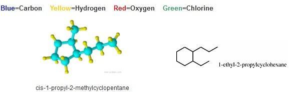

In one internet site it is 1-propyl-2-methylcyclopentane and in other it is 1-ethyl-2-propylcyclohexane
I know when two different substituents could receive the same number, number them by alphabetical order. So I can understand 1-ethyl-2-propylcyclohexane but it contradict with 1-propyl-2-methylcyclopentane. Are they both right?
Wouldn't hurt to see the molecule in question (especially taking into account cyclopentane and cyclohexane are two completely different backbones).
These are two different molecules.
They both are cycloalkanes, I wanted to know how are they numbered for nomenclature.
I learned alphabetical order or by complexity. Your first example uses neither. Maybe the rules have been liberalized.
If there are two substituent consecutively in a cycloalkane, I think it shouldn't matter which ever substituent is numbered 1, because it wouldn't change the molecular structure.
That is,
1-propyl-2-methylcyclopentane or 1-methyl-2-propylcyclopentane,
1-ethyl-2-propylcyclohexane or 1-propyl-2-ethylcyclohexane
Also if there were more than two substituent, they can be numbered , from left or from right.
As long as it's unambiguous, I guess it's OK...fewer rules to have to remember.
