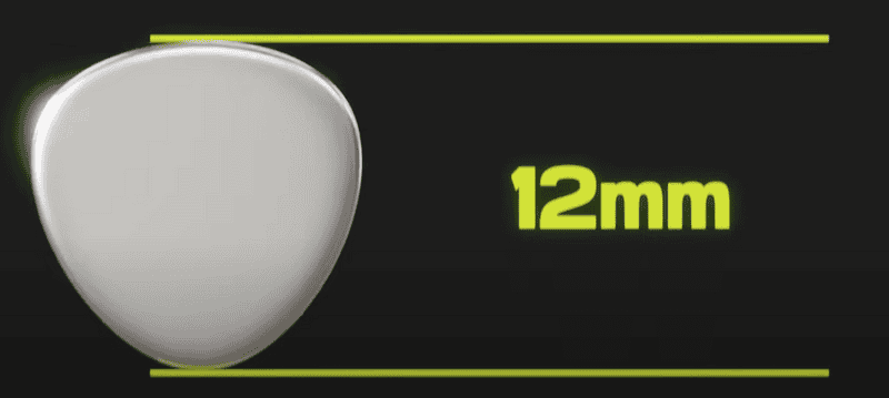

I saw a video claiming that cylindrical dowel pins are not cylindrical but more like a trilobed shape. I'm trying to understand more about it.
I know there are no perfect things when it comes to manufacturing. And when precision is required, the smallest defect can be unacceptable.
I was watching this video about setting a mill up to spec and the author mentioned that dowel pins are not truly rounded so they shouldn't be treated as such for precision calibration of manufacturing tools. Instead, he recommends using proper gage pins which makes perfect sense. After all, that's what they have been made of.
What I don't understand is the explanation about the dowel pins. He actually gives an explanation with nice pictures included but I still don't understand it, probably due to the language barrier and my inexperience with machining.
He claims that, since dowel pins are not grounded between centers, the resulting geometry will be something like this. I don't understand that claim. I tried googling it and asking for information in the YouTube message board but I still couldn't understand it.
Rounded, slightly irregular grey shape with a bright green 12mm dimension line spanning its width, shown against a dark background.
What does grounding between centers even mean?

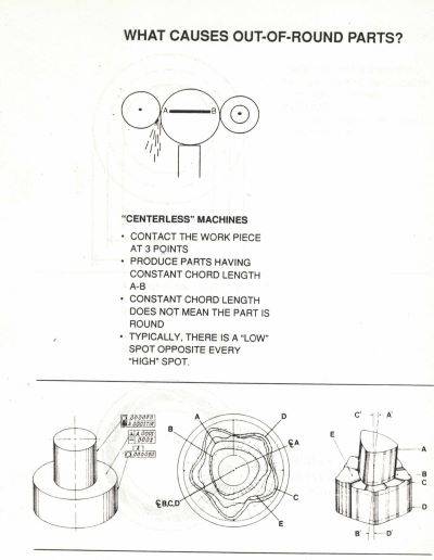

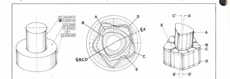

Lobing errors are present on most all production parts. Takes high precision measurement to know truth.
Printed page titled 'What causes out-of-round parts?' showing a centerless grinding diagram with a workpiece contacting three points, and below it three views of lobed out-of-round cross-sections with labelled points A to E.
Three engineering drawings of a stepped cylindrical part with geometric tolerance callouts, a polar roundness plot with labelled lobed contour lines A to E, and a 3D view of a lobed cylinder with labelled sections A to E and primed reference lines.

Short answer is three lobe parts come from parts made in 3 jaw chucks.
if you want more info, let me know,

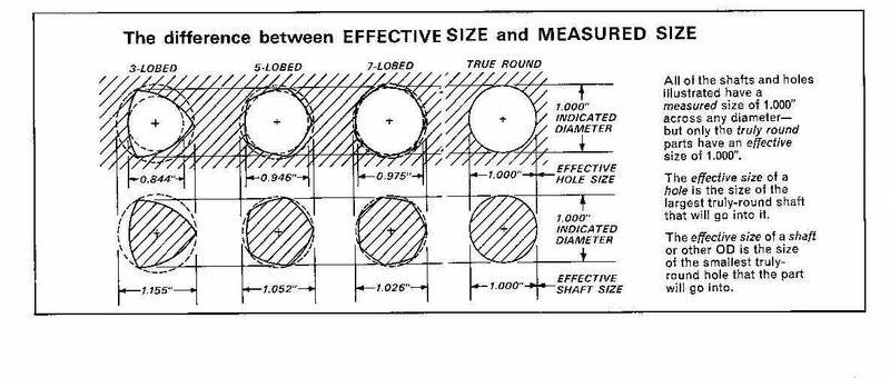

In manufacturing of high production precision parts there are 3 things that must be in tolerance.
Size, Shape and Surface Texture ( bastardized to mean surface finish) in layman terms.
Size is a very loose spec. As this post reveals. Lobing conditions in the manufacturing process mean you will almost certainly have some form error. How much depends on the application. A wheel barrow bushing can have lots of out of roundness but who cares. A wheel bearing using a bushing is another matter. Next comes form error that requires a different measurement technique.

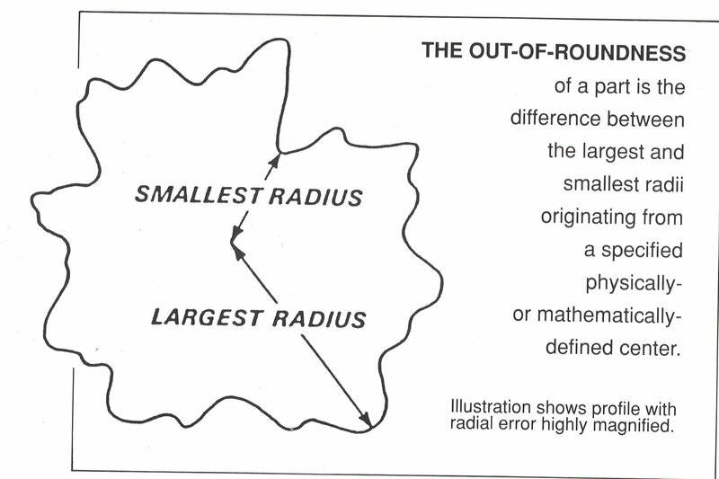

Out of roundness is defined ( by NIST) as the maximum radius minus the minimum radius and can not be measured with common shop floor gages. An example of form error is a fracking elbow suffering blow by at 15,000 psi pressure.
Was generated on a machining center and had 0.003" out of roundness. No wonder it has blow by.
Finally Surface texture requires expensive metrology instruments having diamond stylus contacts wired to electrics to show deviation to the millionth of an inch.
Henry Ford bought a Rolls Royce engine ( circa 1930s0 and had his engineers copy it. They did. Prototype blew up in an hour. They did not look at surface texture. The pistons were mirror smooth. Did not hold lubrication and boom. Chevy Vega sound familiar?
Now you know the Three Ss..Size, Shape , Surface texture of dimensional measurement.

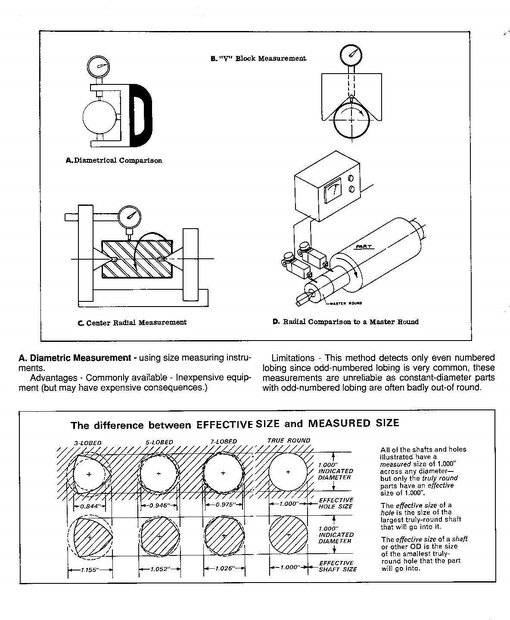

Causes of Form Error - All surfaces of a typical OD are generated with reference to fixed points, axes or lines of contact in the machine tool, be it centerless grinding, lathe centers, steady rests, regulating wheels, tool edges, grinding wheel surfaces. These points of contact are constantly changing. Tool holders flex, there is imperfect rotation, erratic cutting dynamics, tooling wear, lubrication, rotational imbalance and wear, improper machine tool geometry, all contribute to error. Tool holders and holding fixtures slip, belts wear, drive rollers misalignment, chucks distort, localized heating, excessive feed rates, and warped out of round stock all add to the mix.
Finally, it seems that the most common machine tool used, “center-less” Machine tools were designed to make out of round parts! They contact the production part at three points and almost always generate a 3,5 or 7 lobe part.
It should be noted that one could not effectively measure SIZE of high precision parts without knowing the Shape …i.e. effects of form deviation due to lobbing error generated during the machining process.
Knowing Form Error is mandatory, when assembling tight tolerance precision parts. The time-honored mistake of “ tightening up the Tolerance” will not cure the problem. Control of Form Error will reduce scrap, reduce rework, eliminate waste and save time and money.

  • Two-part diagram comparing a 'difference between effective size and measured size' for 3-lobed, 5-lobed, 7-lobed and true round shafts and holes, with indicated diameters of 1.000 and effective sizes of 0.844, 0.946, 0.975 and 1.000 for holes, and 1.155, 1.052, 1.026 and 1.000 for shafts.

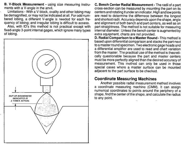

  • Text panel comparing radial measurement methods for out-of-roundness: a V-block measurement diagram with a dial indicator over a part resting in a V-anvil, labelled out-of-roundness indicated is 3 times actual, plus notes on bench center and master round methods.

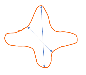

Are you sure about it? It feels impossible to have a constant width part with an even number of lobes.
In the previous article I discussed in mentioned they always come out with an odd number of lobes so the constant width remains. The picture you showed also imposes that the resulting shape must have constant width.
From wiki: https://en.wikipedia.org/wiki/Curve_of_constant_width
Every regular polygon with an odd number of sides gives rise to a curve of constant width, a Reuleaux polygon, formed from circular arcs centered at its vertices that pass through the two vertices farthest from the center. For instance, this construction generates a Reuleaux triangle from an equilateral triangle. Some irregular polygons also generate Reuleaux polygons.
As a counterexample, if it were even numbered, you would not be able to see a constant width across its perimeter. A diametrical measure would reveal differences. Sorry for the crude drawing but this is what I'm trying to say.
Hand-drawn orange closed curve with four rounded lobes, with two blue double-headed arrows marking a vertical and a diagonal diameter across the shape.

This is the reality of the manufacturing world. These shapes exist. They must be understood and either corrected or their magnitude must be known.
NO it would not.

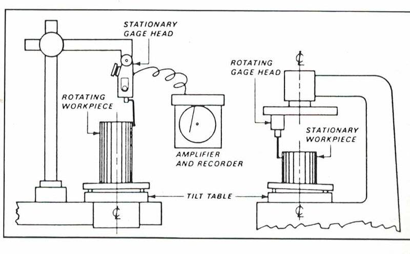

Look at post 12 above. You can only check lobing condition if you are able to measure differences in the RADIUS, not the Diameter, these are two different measurements. You must re-read post 12 and understand.
The part must be placed on a precision rotary table and centered so the change in RADIUS can be measured, or the part is scanned on a high accuracy scanning CMM. we ate talking accurate to 100 millionths of an inch or better. .005 mm accuracy. In this way a center point is used as datum and the radius of the outside diameter can be measured.
  • Line drawing of two roundness measurement setups: at left a stationary gage head on a column measuring a rotating workpiece on a tilt table, with a cable to an amplifier and recorder; at right a rotating gage head above a stationary workpiece on a tilt table.
  • Diagram of out-of-roundness: a wavy, irregular closed profile with arrows from a central point marking the smallest radius and the largest radius, plus printed definition text beside it.
I was referring to even-numbered lobed shapes. I said that because I believe that constant-width shapes can't have an even number of lobes. Does anybody know for sure if it's possible to have even-numbered lobed shapes with constant width? The wiki article I shared earlier focuses on odd numbers, which aligns with the explanation of low peaks and high peaks being opposed so that the diametrical measure remains consistent. Therefore, my crude drawing with 4 lobes was intended to show how this opposition is not possible when the number of lobes is even.

Even-number lobing appears when different manufacturing processes are used. An out-of-balance spindle combined with non-symmetric stiffness generating that kind of shape is something I can fit in my head.
However, how centerless grinding generates constant-width shapes instead of simple circles remains a mystery to me.
For the 3rd time, diameter checks do not see lobing errors. Your constant width fixation ignores what i have said. You can generate what you call constant width parts that still have lobing.
Wikipedia is not the end all source, especially in Metrology.

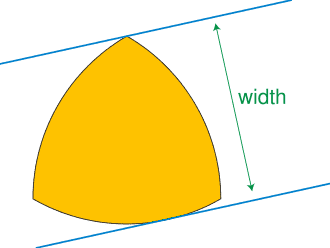

Filled orange Reuleaux triangle with curved sides, held between two parallel blue lines, with a green double-headed arrow labeled width showing the distance between the lines.
Still, that doesn't change the fact that, if the shape doesn't have a constant width, diameter checks will definitely produce different readings depending on the rotation of the shaft. That's how constant width is defined after all. Isn't it?
And if that's true and we consider that only odd-number lobed shapes can have constant width, an even-number lobed shape could be revealed with diameter checks and discarded if necessary. That's what I tried to say with the tangential note that generated this side discussion.

  • Diagram titled 'The difference between EFFECTIVE SIZE and MEASURED SIZE' showing 3-lobed, 5-lobed, 7-lobed and true round shafts and holes with measured widths of 0.844, 0.946, 0.975 and 1.000 inch, and effective sizes of 1.155, 1.052, 1.026 and 1.000 inch.

I don't think I created a new metrology term. Constant width is a well-defined mathematical term to describe shapes that have a constant diameter along its perimeter.
In geometry, a curve of constant width is a simple closed curve in the plane whose width (the distance between parallel supporting lines) is the same in all directions. The shape bounded by a curve of constant width is a body of constant width or an orbiform, the name given to these shapes by Leonhard Euler.[1] Standard examples are the circle and the Reuleaux triangle.
Even if the word constant-width is not a term directly often used in Metrology, it has an impact on it. Circle is also a word from Math and it impacts metrology as well.
More closely related to Metrology, I have seen constant-width being referred to as pseudo-roundness too with an equivalent description.
(Original link in post #2)
Pseudo-roundness is best defined as any shape not perfectly round, which exhibits constant dimensions when measured in any direction between two parallel planes, ie, with a 2 point micrometer.

All sources I could see about constant-width/pseudo-round shapes mention odd-number lobed shapes. Either in written form, drawn or hand-wavy explanations such as "the high spots have low spots opposite to it" which implies they must have an odd number of lobes. To me, the hand-wavy explanation I just gave (I saw it somewhere else) seems solid but I don't have a hard mathematical proof.
A simple counterexample of an even-number lobed shape being pseudo-round / having constant-width would be enough to refute it but I haven't found it yet.
My last attempt - You can have constant width in a tree lobe part and a 4 x class 5' diameter ring gage that is certifiable to 1 millionth of an inch. Both will indicate a constant width. When measured diametrically.
Both fill preform different in a application. One will have perfect sealing in pressure applications. One will have blow by and not seal due to form imperfections.

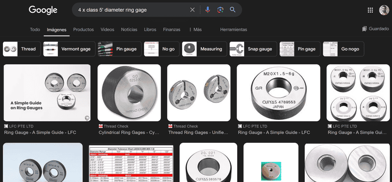

I'm sorry but I'm not sure I'm understanding the first part of the message.
You say you can have a three-lobe part and a what? I tried typing "4 x class 5' diameter ring gage" on the browser.
Google Images search results for "4 x class 5 diameter ring gage" showing ring gauge thumbnails, including a Thread Check cylindrical ring gage, a threaded ring gauge pair and a labelled ring gauge.
I think you're saying that both the male part and female hole, if having constant width, will produce the same measurement if their diameters are checked. Is that what you meant? I agree with that from the beginning.
And I agree with you in the second part of the message as well. The closer to a circle, the better seal will be obtained.
Having constant width isn't enough to guarantee proper seals because, although circles have constant width, not all constant-width shapes are circles.
Constant width means that a diameter measurement will always produce the same result no matter at which point it is measured. Alternative measure methodologies must be used to correctly describe the form as you stated before.
If the manufacturing process can only result in constant width shapes (centerless grinding), then the more lobes the better since it'll be closer to a circle.
I believe the point where we disagree is that I think constant width is only possible with an odd number of lobes and you disagree.
I insist, I'm not saying an even number of lobes isn't possible. We have discussed that already. I'm not even saying that an even number of lobes won't perform correctly. Since having more lobes could make it closer to a circle (depending on what we mean by a term as broad as "closer"), then it's possible it'd work better for seals even while lacking the constant-width property. I'm just saying I don't believe that'd be a constant-width shape.
Still, I don't consider that to be the main point of discussion of the thread anyway. As I stated in a previous post:

In an even lobed object you will have the points 180 degrees opposite each other and the curves 180 degrees opposite. These features will add instead of subtracting like in the odd lobed ones where a point is opposite a curve.
