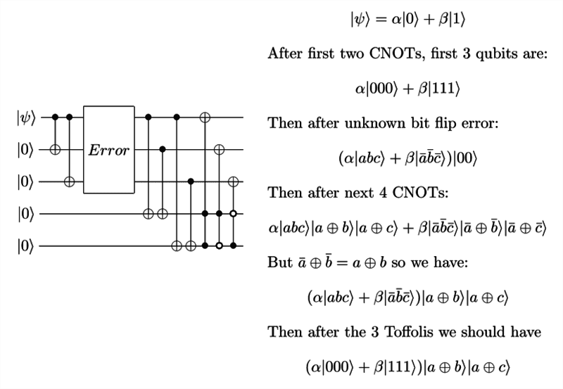

I remember when I was learning about bit flip correction, I think I found a way to correct it with 3 toffoli gates without measurements. At least, I'm pretty sure it was separable. I don't know if it's possible with phase errors as well, could be.

Here is the circuit I had. At least 2 of a, b and c are 0, and [itex]\bar{a}[/itex] means not a etc.
I found the paper you mentioned:
Landauer 1 pointed out that the only logical operations that necessarily require dissipation are irreversible ones, such as error correction, in which the logical input cannot be deduced from the output.
In the circuit I posted, instead of having a cost in terms of energy, it costs you 2 ancilla qubits of a known state, they end up in unknown states. So although the state after the error is unknown, so are the states of the 2 ancilla qubits at the end, so it doesn't require dissipation.
Also, this circuit is reversible, but it doesn't do error correction when it runs backwards. It does initialization! The two unknown bottom qubits are transformed into 0, at the cost of the pure state [itex]\alpha|000\rangle+\beta|111\rangle[/itex].

Wow that's brilliant and will probly take me awhile to fully understand.
