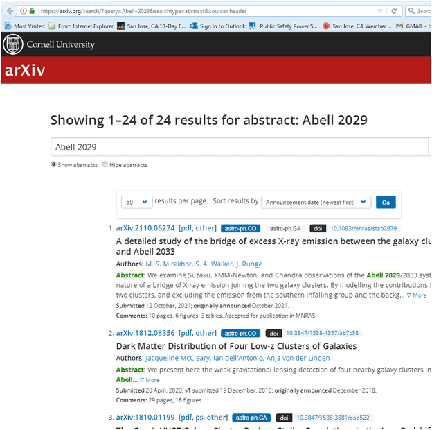

Hi @masher:
The date 2029 seems to be an error. The link fails to work.
Regards,
Buzz
Link works for me (running Firefox on an old Vista PC):
Works for me too with Firefox and an old MacBookPro
The eighth paper on the list that I find is https://arxiv.org/abs/1612.06428
