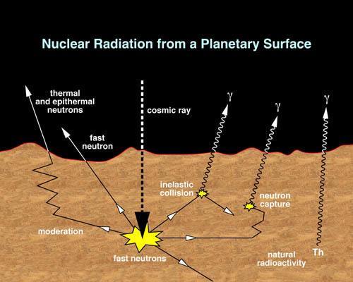

It will be really nice if the probe gets within range (e.g. 375 km) where it can use gamma and neutron spectroscopy to detect the chemical elements in the surface material! This is getting to be my favorite picture about the mission:
The ratio of thermal (slow) to fast neutrons tells the fraction of HYDROGEN (i.e. water) in the soil down to depth of 1 meter. Because hydrogen nuclei are by far the best nuclei at "moderating" (i.e. slowing down). The more of the neutrons detected by Dawn are slow, the "juicier"/icier is the planetto :woot:
