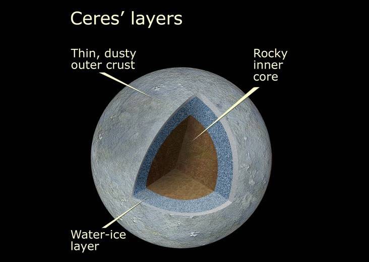

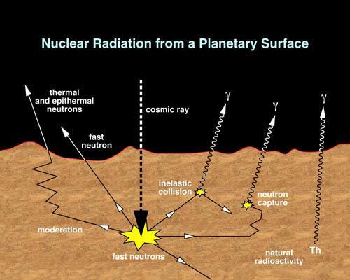

Since we turned a page, I'll bring forward the post summarizing some reasons one might be especially interested in studying Ceres and in the current exploration by Dawn.
==quote post #748==
Just as a reminder, what now happens has consequences for human history because Ceres is (by a wide margin) the nearest icy dwarf planet and offers an advantageous site for chemical and materials manufacture in low gravity. Whether or not this will be developed depends somewhat on Ceres layer structure and chemical composition
Thinking has changed about the layer structure (Lakdawalla report on recent AAS conference) because at least in some regions craters remain sharply defined and are slow to smooth out---suggesting they are supported on a slow-flow rock+ice mix that could be as much as 60% rock. The searchable online cutaway GRAPHICS go back to 2005 and 2006 when scientists had only Hubble space telescope images to go on. I couldn't find any updated cutaway diagram showing more recent guesses about layer structure.
There were also reports at that AAS conference of detection of ammonia-bearing clays in the hydrated minerals at Ceres' surface, by optical/IR spectroscopy, which would be important if confirmed. Nitrogen is a key chemical element for both manufacturing and biology--common in outer solar system bodies but unexpected on an asteroid belt body like Ceres.
Anyway if things work out as planned we now get to learn a great deal more about Ceres' chemical and layer composition. This kind of graphic will hopefully be revised:
The icy layer should be more indicative of a 60-40% rock+ice mix. Orbit tracking should be able to map subsurface irregularities in density. Gamma and neutron spectroscopy is to measure the abundances of various chemical elements in surface material, to a depth of about 1 meter.
The last (chemical abundances) is especially significant so I'll bring forward the graphic. Spectroscopy depends on activation by cosmic ray particles.
Impact by cosmic rays (high energy protons, mainly) causes a sparkle. The frequencies of the gamma-ray sparkle reveal the identities/abundances of the atoms giving off the sparkle. Moreover among the scattered neutrons the fraction of them which have been slowed by successive collisions with hydrogen nuclei reveals the amount of hydrogen (e.g. water ice) in the surface material.
==endquote==
