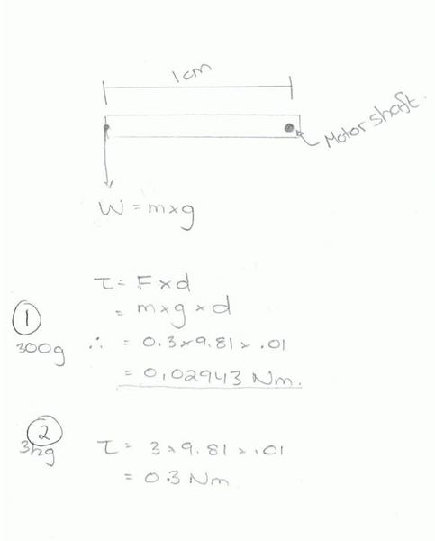

stupid question with the kg-cm.
Lets say i had a 1cm long beam (can think like a cantileaver) which had its centre of mass at the end**
For case 1 where the COM is 300grams, I am assuming it would be able to rotate the beam. Since the torque applied is 0.03Nm (this is the equivalanet of the 0.3kg-cm isn't it??)
For case 2 where the COM is 3kg would it be able to turn the beam.?? I am assumnig not since its over the 300g-cm stated on the motor.
Yep it would be able to turn the 1st case but not the 2nd for the reason you stated.
