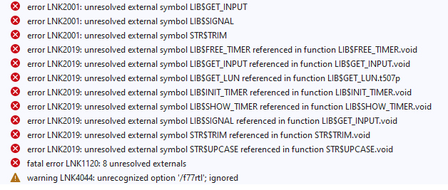

trying to revive some stuff from 40 years ago.
Found I could download and install Intel Fortran which seems to be a descendant from an old DEC VMS friend. Even managed to get it 'integrated' into Visual Studio 2022 (somewhat; haven't got a decent help or debug facility running yet... and no idea how to hook up runtime libraries).
Overwhelming experience; and a far cry from DCL
$ For aap | $ Link aap | $ Run aap
But I'm sure there are good reasons for all this progress :smile:
My current issue:
Need help to resolve symbols like STR$... and LIB$... that were in the runtime library
(e.g. :
Severity Code Description File
error LNK2019: unresolved external symbol STR$UPCASE referenced in function STR$UPCASE.void CMR$DEFAULT.obj
For the debugging and help there are some clues, but I quickly find myself drowning in side issues in a world that seems to abhor the word fortran :rolleyes:

Now: what do I have to do to resolve these LNK2019 errors ?
I added /f77rtl in Project | Properties | Fortran as additional options - makes no difference
Adding /f77rtl to the linker command line gives
warning LNK4044: unrecognized option '/f77rtl'; ignored LINK
Makes sense, but I'm still stuck with unresolved externals
I installed w_ifort_runtime_p_2024.1.0.968.exe but can't find where it puts the stuff.
(anyone ?)
Had good fun and success with this setup in another thread (with no LIB$... etc) so the whole machinery seems to work OK....
Frustrating

But at the moment I am interested in dealing with these:
Can't suppress the feeling there is a simple solution. If I get frustrated just a little more I will embark on simply writing them from scratch :doh:
:smile:
Let's describe the problem in more accurate terms.
You have Fortran code from 40 years ago that used non-portable extensions (the "blue pages"). Now you have discovered this code is, exactly as promised, non-portable.
I understand why you don't like this situation, but it shouldn't be a surprise.
I see three options:
  1. Keep trying other compilers, hoping they have implemented these functions. Your best bet will be with commercial compilers, like PGI or IBM.
  2. Figure out what these functions do, and write code that does the same thing with the same name and link it in.
  3. Figure out what these functions do and re-write the application code to do this some other way so as to use only portable code.
I know none of these are appealing, but unfortunately, it is unlikely to find a switch "--compile-old-incompatible-code-correctly".
