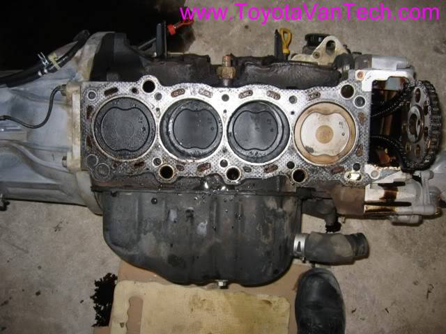

I have seen how clean a combustion chamber is when a head gasket fails between a coolant channel and cylinder. I have no doubt that water can clean carbon deposits.

Water does a nice job decarboning the piston/cylinder area but has virtually no effect on the intake side of the intake valve or EGR passages and that is where the majority of carbon build up happens. This is much more of a problem in direct injection engines. The PCV system functions to recycle combustion blow-by through the intake. It builds up on the intake valve where the venture effect causes low pressure and the combustion contaminants condense out and adhere to the valve head. This requires chemical or mechanical removal and can not be removed with water. You can decarbon part of your engine with water, but you are treating the part of the engine least affected by carbon buildup.
