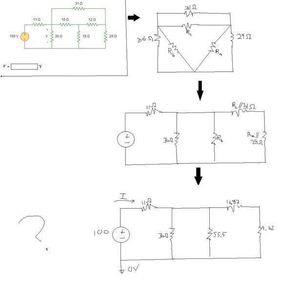

URGENT: Delta-Wye transformations
Hello there. In my electrical fundamentals class (a 201 level class), we just barely started Delta-Wye transformations. However, the homework that is due online tonight uses full transformations...confused, I have just tried to work through this using the book. I have become stuck...
My homework is due tonight at midnight, so please help asap?
All attached
Ohm's law, and...I don't know the other ones
I have worked through most of the solution in the jpg. However, I am stuck. I know I need to find I, because if I can find I, it would be very simple to use Ohm's law in the original circuit.
I have tried to add the series and do parallel to leave
16.87 + 9.62 || 55.5 = Rd
then Rd || 36
Then you are left with a simple circuit to determine I, which I calculated to be 4.4A.
Can someone please help? haha

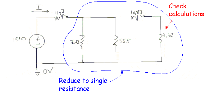

Check the value that you obtained for Ra from the Y-Δ transformation; either it's not correct or something went wrong with combining it with the 29Ω resistor. Then continue to reduce the network until you're left with two resistances forming a voltage divider.
