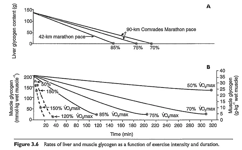

Get a copy of Lore of Running 4th Edition, by Tim Noakes, MD. The answer to your question is in there, although you will need to spend some time digging. If not in the text, the list of references runs about 100 pages. Sample from page 107 (MUCH more in the text):
My question was whether fat burning can occur before glycogen stores got depleted? Any other reference that directly address it? The book Lore of Running is about running. I simply want to know if one walks for 2 hours a day and not run, whether fat burning can occur if the liver glycogen is still not 0%.
The ratio of fat versus glycogen burning is a function of exercise intensity, duration, aerobic fitness, diet, and other variables. The chemistry is similar for running, walking, swimming, cross country skiing, or other exercise. It's all covered in the book.
