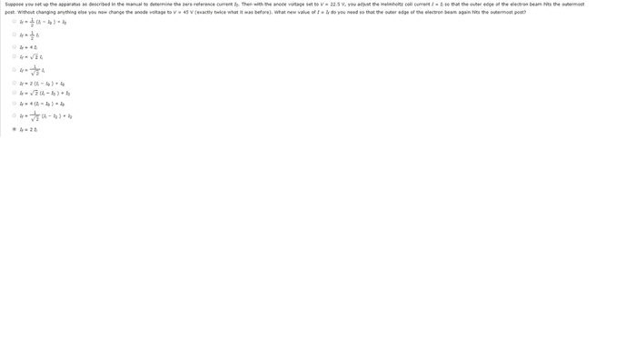

Hi, I'm having trouble solving this problem:
I can't seem to get to the right derived formula. The one selected is wrong. I'm still attempting to solve this.
