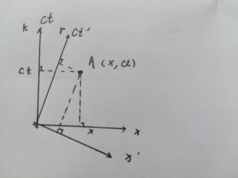

How to derive Lorentz transformation in Minkowski four-dimensional spacetime diagrams?
I attempted to draw a Minkowski four-dimensional spacetime diagram, using frame K as the reference frame. I identified a point A with spacetime coordinates (x, ct). My goal was to find its spacetime coordinates in frame r, which moves at a constant velocity v relative to K.
I tried drawing perpendicular lines from point A to the axes of frame r and attempted to determine the coordinates of these perpendicular points. However, I realized this approach might be incorrect because it doesn't yield the Lorentz transformation.
Could someone please help me with this? Thank you!

The ##x'## axis rotates counter-clockwise (hyperbolic rotation of the coordinate system), see
https://www.geogebra.org/m/NnrRvA46
Also, the scales of the ##ct'## and ##x'## axes change with velocity.
This keeps the speed of light in vacuum (45° world-line) the same in both coordinate systems.

I'm one of the few students, it seems, that finds spacetime diagrams confusing. The problem is that the diagram you have drawn is in Minkowski spacetime, and is not Euclidean. You cannot apply a Euclidean interpretation of lengths and angles. Pythagoras's theorem does not apply!
You have to relearn how to interpret the geometry of a Minkowski spacetime diagram. If I'm honest, I never mastered this. For me, the Lorentz Transformation is too complex to visualise and I rely on algebra.

Draw x-t axes with a scale chosen so that ##c=1##, as you have done.
Draw the path of an object moving at constant speed ##v## passing through the origin. This object is at rest at the origin of the x'-t' coordinate system, so this is your t' axis.
Draw two more objects moving at speed ##v## equal distances ahead and behind the first. Have the middle object emit (at the same time) light pulses in both directions. The arrival of the pulses at the front and rear objects must be simultaneous in the x'-t' frame, so a line through these events must be parallel to the x' axis (as others have noted, the slant of the x' axis in your image is the wrong way).
Draw a light clock of period ##T## at rest in the x-t system. You know that the period measured by the x'-t' system is ##\gamma T##. Drop linesfrom two consecutive ticks parallel to the x' axis and mark where they cross the t' axis. The distance between them is ##\gamma T## on the t' axis, so now you can draw the "lines of constant t'" part of the x'-t' grid.
Draw a light pulse emitted from the origin and mark where it crosses the t'=1, 2, 3,... lines. Drop lines from these parallel to the t' axis. These are the "lines of constant x'" part of the x'-t' grid.
With the grids it shouldn't be difficult to derive the transforms.

Given a line, to draw a "perpendicular [to it]" in Minkowski spacetime...
from my answer https://www.physicsforums.com/threa...me-meaning-visualization.1016318/post-6644678 ,
use Minkowski's construction
From Minkowski's "Space and Time"... $$
We decompose any vector, such as that from O to x, y, z, t into four
components x, y, z, t. If the directions of two vectors are, respectively, that
of a radius vector OR from O to one of the surfaces \mp F=1, and that of
a tangent RS at the point R on the same surface, the vectors are called
normal to each other. Accordingly,
c^2tt_1 − xx_1 − yy_1 − zz_1 = 0
is the condition for the vectors with components x, y, z, t and x_1, y_1, z_1, and t_1 to be normal to each other.
In other words, draw a "circle"
(in Minkowski spacetime, [the future-branch of] a hyperbola--- the locus of events (say) one-tick-later along inertial-worldlines from event O ) centered at the origin.
To construct a "perpendicular" to a line, find the intersection of your line and the "circle".
Construct the tangent at that intersection point.
(Key idea: The tangent is "perpendicular" to the radius.)
Through the origin, draw a parallel to that tangent line.... That is the x'-axis for the observer along the t'-axis.
