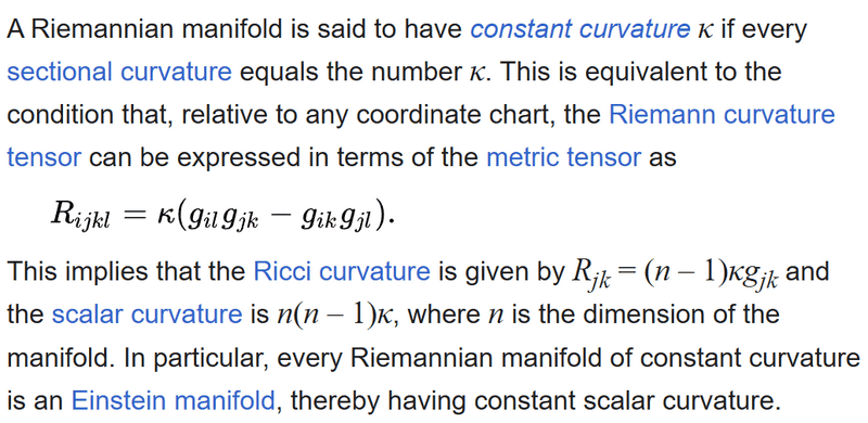

Why not just make use of the simple formula below for the Riemann tensor of a manifold of constant curvature?
(https://en.wikipedia.org/wiki/Riemannian_manifold)
Then you only have to contract twice with the inverse metric to get what you want.
EDIT: As correctly pointed out by @Orodruin, my comment is only valid for constant curvature (e.g., a 2-sphere) so it is inapplicable for a general 2d curved manifold; i.e., never mind!
I don’t think we were to assume constant curvature.
