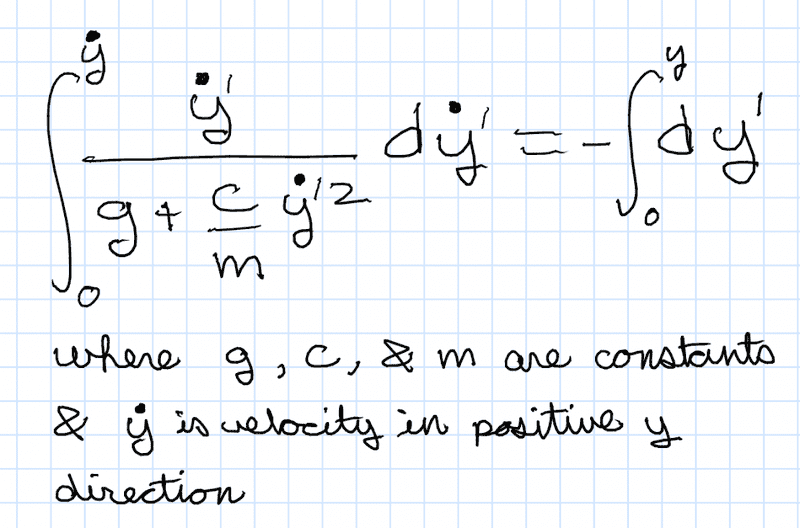

Integrate:
Handwritten equation: integral from 0 to ẏ of ẏ' dẏ' over (g + (c/m) ẏ'^(1/2)) equals negative integral from 0 to y of dy'. Caption below: where g, c, and m are constants and ẏ is velocity in positive y direction.

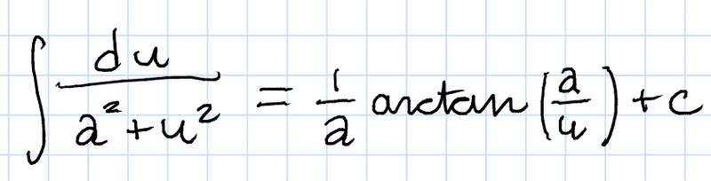

Handwritten integral: the integral of du over (a squared plus u squared) equals one over a times arctan of (u over a), plus c.
I tried to get rid of the velocity in the numerator on the left side to use the relevant equation but to no avail. Any tricks on how i can integrate this? Also, this a small part of a larger mechanics problem.
Thank you[/B]
Unless you tell us exactly how you tried to do that we cannot know where you went wrong. Another general tip is to use the forum LaTeX capability to write equations. It becomes much easier to read your posts and quote appropriate sections.
A tip related to your integral: What is d(t^2) expressed in t and dt?
