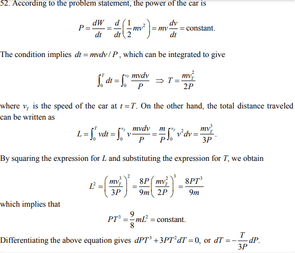

This one was on my previous post. I would like to know why this works. Why is it possible for us to apply a derivative in this case? Here's the full solution:
The problem statement: A funny car accelerates from rest through a measured track distance in time T with the engine operating at a constant power P. If the track crew can increase the engine power by a differential amount dP, what is the change in the time required for the run?

I'm not sure about the last part where it takes the derivative of the equation, $$PT^3 = \frac{9}{8} m L^2$$ Why would one take a derivative in this case? I mean sure, it could be that they just want to get that infinitesimal time ##dt##, but is there anything more behind the reasoning?
I’m not entirely sure what the problem is but this might help and hopefully is not overkill...
First, note that ##dP## and ##dT## is infinitesimals. ##\delta P## and ##\delta T## represent small changes. So the question should really ask:
“If the track crew can increase the engine power by a small amount ##\delta P##, what is the corresponding change in the time, ##\delta T##, required for the run?”
A small change in power, ##\delta P##, will result in a small change in run-time, ##\delta T##. We need an equation which relates ##\delta T## to ##\delta P##.
Note that ##\frac {\delta T}{\delta P} \approx \frac {dT}{dP}##.
It turns out that for small enough changes, we can replace ##dT## with ##\delta T## and replace ##dP## with ##\delta P##.
Since the result of differentiating here is
##dP T^3 + 3PT^2 dT = 0##
it follows that
##\delta P T^3 + 3PT^2 \delta T \approx 0##
So we now have the (approximate) relationship between ##\delta T## and ##\delta P## that the question required. To get this we used the results of differentiation.

For the second problem:
The task is to find how a small change in one variable affects a dependent variable. That is what derivatives do.
