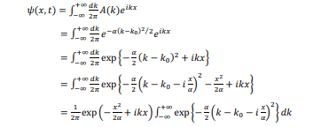

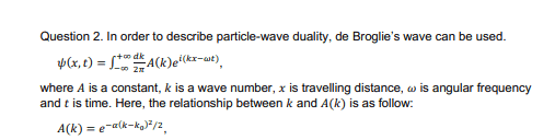

sus1234
Trying to understand how the time independent wavefunction is derived from this
It is asking to derive the time-independent wave function and has managed to get the answer of
and i am very confused as where (ix/a) and (-x^2/2a) came from ?
Thanks.
The answer's wrong.
First, change variables to ##k' = k-k_0##, and then complete the square.
vela said:
The answer's wrong.
Hi,
Thank you for your reply, I'm not sure where I'm meant to sub in k' = k-k0, could you provide more guidance ?
thanks
You've never changed the variable of integration?
