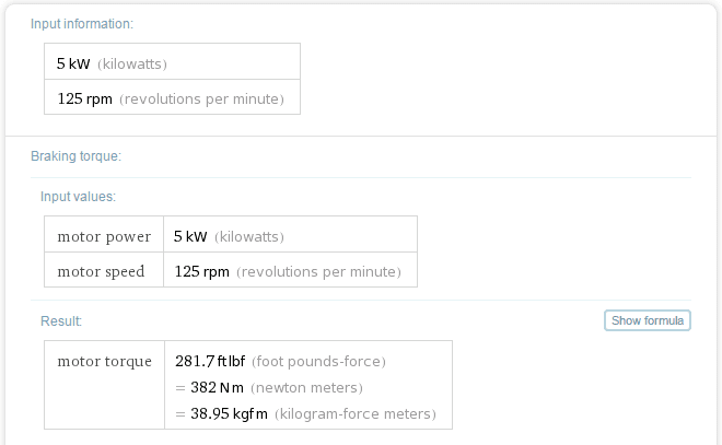

Given your power and speed requirement, you can also calculate the torque the gear has to be designed for. See here:
http://www.wolframalpha.com/input/?i=5+kW+at+125+rpm
