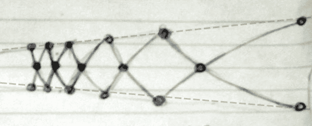

Giving some curve to the component armlets changes the game:
Notice how the left end's range is comparable to the right end's range.
Baluncore said:
The individual members will not necessarily have the hinge point hole in the exact centre, so extension may also be tapered.
That is what changes the game and makes it possible.

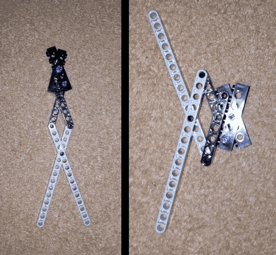

Really? I must be hallucinating the one I just built then...
The edges of the first diamond are four Lego spots (a unit of measure that will surely be included in the next SI update) long and the edges of the second are two spots long, as per Baluncore's posts. Apologies for the dreadful photography.

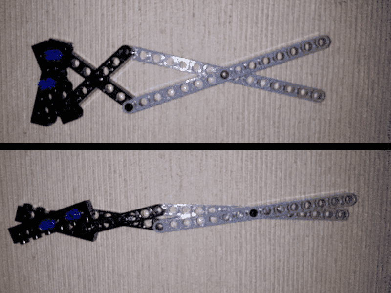

And here's a version to @DaveC426913's original design (again, apologies for the terrible photography):
Note that the upper image is maximum collapse for this design. Interesting toy, Lego.

Consider a scissor as a pair of identical hinged legs. The hinge pin will be somewhere between the end pins. Each pair of legs has an input length to the hinge, and an output length from the hinge. The ratio of the output to input length sets the rate of taper of that stage of the assembled arm.
There are many degrees of design parameter freedom. The simplest specification is probably that the input length of a pair should be equal to the output length of the previous pair.
Another might be that the width of a leg be scaled in proportion to it's length, which is also good from a leg moment point of view, and packs well when close.
