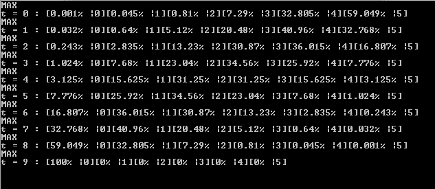

Ok so I made a program that takes all possible 6 length (arbitrary number for now) sample subsets, this is a simplified example, where the distribution is linear.
Now we notice that when t = 0 , 59.049% of the time 5/6 elements of the sample were bigger than t, when t = 1 20.48% of the time 3/6 elements were bigger than t, etc. Format is
"t = x : [percentage of the time that k/6 elements of the sample are bigger than t when t is x | k]. "

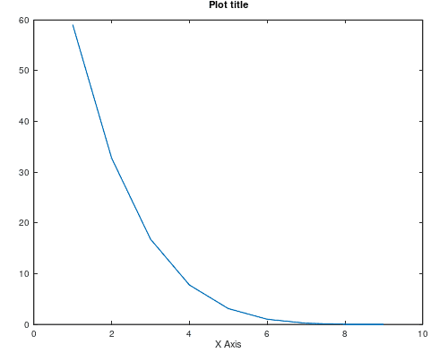

Here is a unnormalized graph of y = percentage time that t = x (for the case of 5/6 elements are greater)
I believe I can answer my question if I can understand why the graph is that shape and what type of graph it is. Any ideas?

It seems like you are asking for the distribution of the sample median coming from a normal population? Or maybe you are coming up with a statistic to test for skewness of your population? The latter would not make sense.
