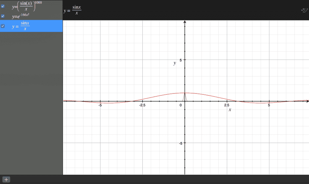

Yesterday I was thinking about the central limit theorem, and in doing so, I reached a conclusion that I found surprising. It could just be that my arguments are wrong, but this was my process:
1. First, define a continuous probability distribution X.
2. Define a new random variable y = x1 + x2 + x3 + ... (Y is the sum of many independent samples of X).
3. To visualise the distribution of Y as you sum each term, I imaging starting with the pdf of X, and convolving it with the same pdf. Then I take the result, and convolve it again with the pdf of X, and so on. According to the central limit theorem, each time you convolve the result again with the pdf of X, the new result will look more like the normal distribution, and this is the case (I have visualised this myself with graphical convolution animations).
4. It was at this point that I realized that the Fourier transform of a Gaussian is also a Gaussian.
5. I also recalled that convolution in the original domain (i.e. the operations we performed in 3) is the equivalent of multiplication in the Fourier domain.
6. As a result of points 4 and 5, that implies that the Fourier transform of pdf of X, raised to a large power, will approximate a normal distribution.
What I find surprising about this conclusion is that it is possible to create almost any pdf of your choosing, even a randomly drawn squiggle that is positive and integrates to 1, and its FT^n (where n is large) will always be approximately Gaussian. Is this correct? I am trying to find an intuitive explanation for this.
Thanks for the help!
Nat

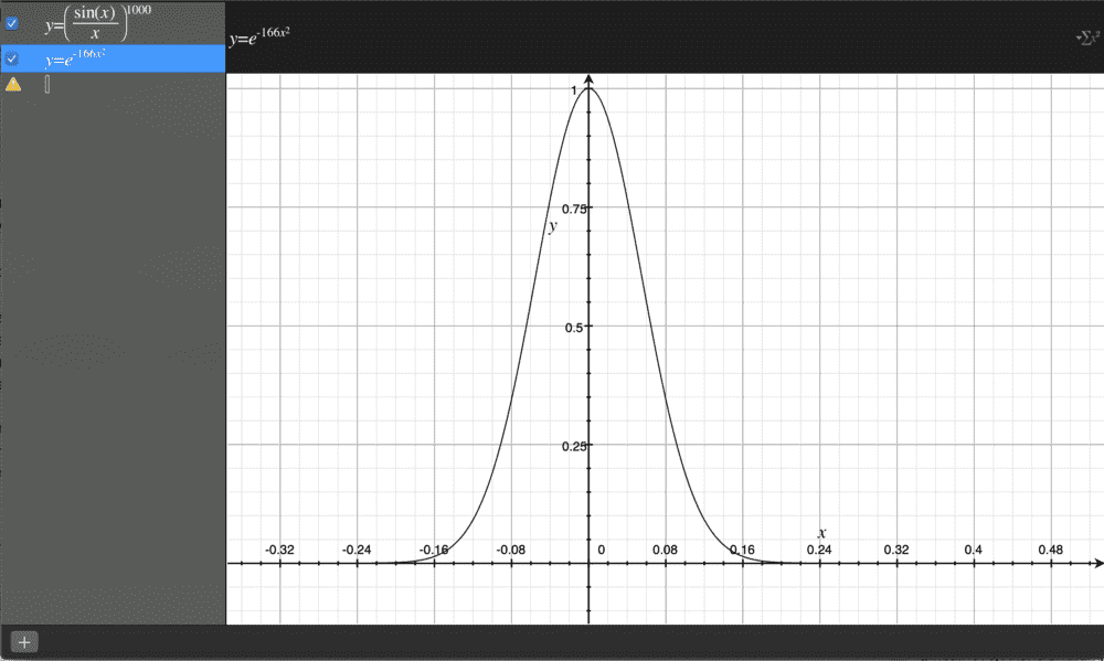

Perhaps I didn't state my hypothesis as well as I should have. It's the Fourier transform of zero-mean pdf, raised to large n, that will approximate a Gaussian. That is:
## \lim_{n \rightarrow \infty}\left( \mathscr{F}\left[f(x)\right]\right)^{n} \approx c_{0}e^{-c_{1}\omega^{2}}##
We are convolving the PDFs in the original domain to find the new distribution of the summed variables. This would be the equivalent operation of multiplying the Fourier transforms of the PDF in the frequency domain.
(a modified version of my hypothesis works will non-zero mean PDFs as well, but in this case we look at the real power spectrum instead of complex FT - we'll ignore this for now for simplicity, and only consider zero-mean pdf's).
In the case of a zero mean uniform distribution, the Fourier transform is a real valued sinc function. When the sinc function is raised to a large power of n, the result is almost exactly Gaussian (I didn't prove this analytically, but I plotted both).

Yes, I realized after I sent my reply that you meant the nth power of Fourier transform of the pdf. The ##sinc(s)## function, though, has zeroes at regular intervals. Wouldn't ##sync^n(s)## still have zeros at the same points?

Yes, this is certainly the case. However, the limiting behaviour takes care of this; as n gets large, the resulting Gaussian approximation gets "squashed" towards to centre, and so the first zero crossing actually occurs at some extreme standard deviation, where the exact Gaussian is almost 0 anyway (and the error at all the crossings approaches zero as n goes to infinity).
NOTE: In the plots, the approximation overlays the actual Gaussian, and only appears as one black plot, when if fact there are two black plots.
  • Graphing software screenshot plotting y = sin(x)/x in red and y = e^(-166x^2) and (sin(x)/x)^1000 in grey, with x axis from -5 to 5 and y axis from -5 to 5.

  • Graphing calculator screenshot plotting y = e^(-166x^2), a narrow bell curve peaking at 1 at x = 0 and falling to near zero by about x = ±0.16, with axis labels from -0.32 to 0.48 on x and 0.25 to 1 on y.
