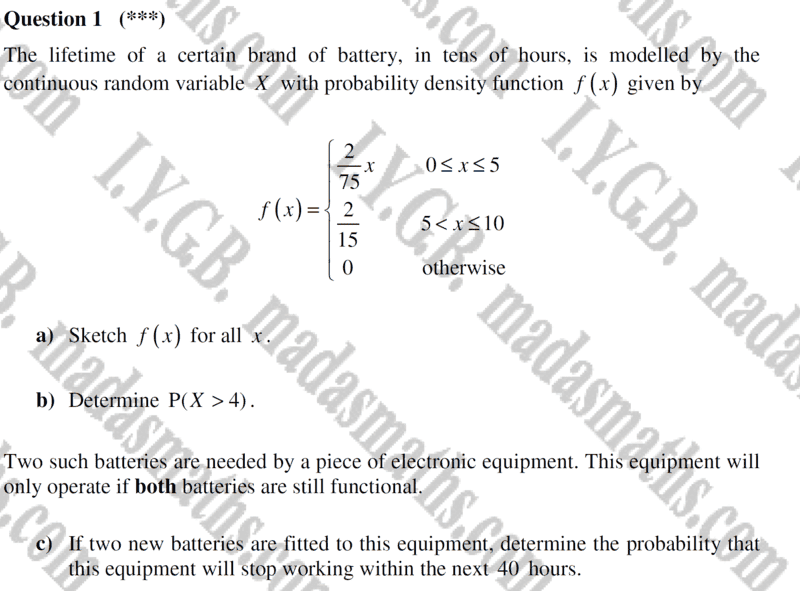

see attached
Knowledge of distributions
Printed exam question 1 on battery lifetime: piecewise density f(x) = 2x/75 for 0 ≤ x ≤ 5, 2/15 for 5 < x ≤ 10, and 0 otherwise; parts a) sketch f(x) and b) find P(X > 4).
Find the solution here;
Answer strip showing an empty box, then P(X > 4) = 59/75, then 2144/5625 ≈ 0.381, with the fractions boxed.
Ok my interest is on part (b) and (c) only. Let's start with (b),
My take is,
$$\int_4^5 \dfrac{2}{75}x\,dx=\left.[\frac{x^2}{75}]\right|_4^5$$
$$=(0.33333333-0.21333333)+\frac{2}{15}×5$$
$$=0.12+0.6666666666=0.78666666$$
note that at ##f(x)##=##\dfrac{2}{15}##, the probability value will be the area subtended by values of ##x## from ##x=5## to ##10## hence ##10-5=5##...in short, probability ##P(x>4)## at this point will be the area subtended by the straight line within the given domain ##5<x≤10##.
You are confusing the reader with all those decimals. The general rule is
[tex] \mathbb P(X\leqslant a) = \int _{-\infty}^a f(t)\mathrm{d}t,[/tex]
if ##X## has a probability density ##f##. For b) apply what you know about the probabilities of an event and its opposite event.
If you are looking for feedback, explain your thought process that leads you to a certain computation. The probability you are looking for in c) is that at least one battery fails within the next ##40## hours, because both batteries are required for the device to work.

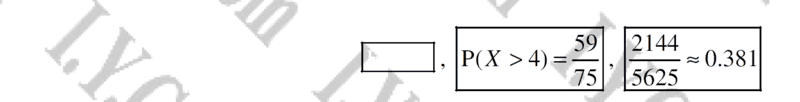

Thanks mate.
Find the solution below from the Markscheme.

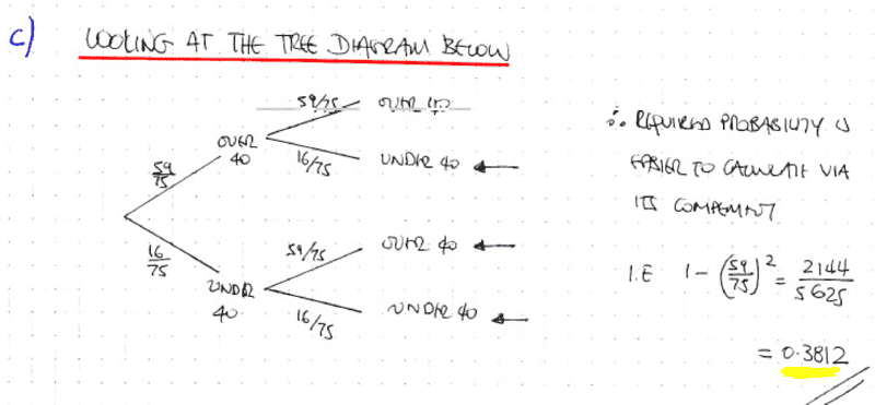

Now for part (c), i was not understanding how they came up with using part (b) to realize the solution i.e
Handwritten working for part c: a tree diagram with first-stage branches 59/75 (over 40) and 16/75 (under 40), second-stage branches labelled 59/75 and 16/75, leading to outcomes over 40 and under 40, with the complement method 1 - (59/75)^2 = 2144/5625 = 0.3812 underlined.
...then i realized from the question itself indicate...in tens of hours... implying in our case, ##4## × tens of hours = ##40## hours. The steps to final solution is very much clear to me. Cheers guys.
