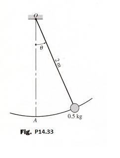

14.34 The 0.5-kg bob of the pendulum travels a complete circle about the pivot
point O. Determine the smallest possible speed of the bob in position A if it is
suspended from (a) a rigid rod of negligible mass; and (b) a string

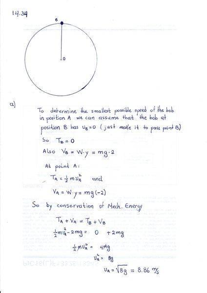

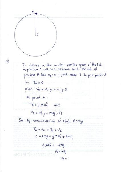

I can see that the above solution is not correct.
Do I take the potential energy at A to be 0 and potential energy at ##B=mgy## where y = 4 ?
Can you check this?
Any hints for part (b)?
It looks like you swapped the kinetic energies of A and B. You have TA + VA on left side of one line, then it goes to 0 - 2mg on the left side of the next line. TA is -2mg, but VA should be ½mv2, and VB should be 0.
Taking point A to be y=0 is a valid strategy, as well.
Ah yes you're right about the swapped kinetic energies. I wasn't consentrated.
Here is the corrected solution:
Is this correct?
