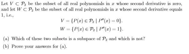

Hi guys, back again...Any help on this question would be appreciated.
Thanks in advance :)View attachment 803

The test for a subspace is that if it contains $x$ and $y$ then it also contains $x+y$ and $cx$ (where $c$ is any constant). Apply that test to each of those two subsets.

First find all polynomials whose second derivative is 0 , do you know how to do that ?

Start by the general form $$P(x)=ax^2+bx+c$$ then try to find the constants , what do you get ?

So if you double differentiate, 2a=0 for the second derivative to yield 0?

you can use integration
$$p''(x)=1$$
$$p'(x)= x +b$$
$$p(x)= \frac{x^2}{2} +bx+c$$
$$p''(x)=0$$
$$p'(x)= a$$
$$p(x)= ax+c$$
Now test each one to see whether it forms a subspace .

Does this correctly answer the question?Test if subsets are closed under multiplication.a*($$ \frac{x^2}{2} +bx+c$$)d^2/dx^2(a*($$ \frac{x^2}{2} +bx+c$$) = aTherefore since a*p(x) does not equal p''(x) not closed. Hence not a subspace.
a*($$ ax+c$$)
d^2/dx^2(a*($$ ax+c$$)) = 0
Therefore since a*P(x)=P''(x) this subset is a subspace.Thoughts?
I think I may have misled you in my first comment by using bad notation. The situation is that if you have $P(x)$ and $Q(x)$, and $c$ is a constant, then you need to test whether $P(x)+Q(x)$ and $cP(x)$ satisfy the appropriate condition.
To avoid doing the exact same problem for you, suppose for example that you were given the set $U$ of all polynomials whose third derivative is 3: $U = \{P(x)\in\mathcal{P}_3|P'''(x)=3\}$. If $P(x)$ and $Q(x)$ satisfy that condition then $P'''(x) = Q'''(x)=3$, so $P'''(x)+Q'''(x) = 3+3=6$. So the third derivative of $P(x)+Q(x)$ is $6$. But $6\ne3$, so $P(x)+Q(x)$ does not satisfy the condition for being in $U$. Therefore $U$ is not a subspace. Incidentally, the third derivative of $cP(x)$ is $3c$, and since $3c\ne3$ (unless the constant $c$ happens to be equal to $1$), $U$ does not satisfy either of the conditions for being a subspace.
Edit. Your previous comment #10 is a mostly correct solution. It shows that the first set is not a subspace. But to show that the second set is a subspace you need to check that it satisfies both of the conditions for a subspace (vector addition as well as scalar multiplication). But you might also like to see the method I have used in this example above.
You can use the method Oplag illustrated or you can do the following
we have proved that all the polynomials of degree 2 that satisfy the conditions must be of the form
$$P(x) = \frac{x^2}{2}+bx+c$$ were $$b$$ and $$c$$ are arbitrary numbers .
So the set contains only second degree polynomials with a leading coefficient $$=\frac{1}{2}$$ .
Now , if we choose two polynomials in the set ,say, $$R(x) = \frac{x^2}{2}+x+1$$ and $$Q(x) = \frac{x^2}{2}+x+2$$
We know by definition that a subspace must be closed under addition . Now, if we add the two polynomials , do we get a polynomial that is still in the set ?

Both methods make sense to me, cheers for the help guys!
