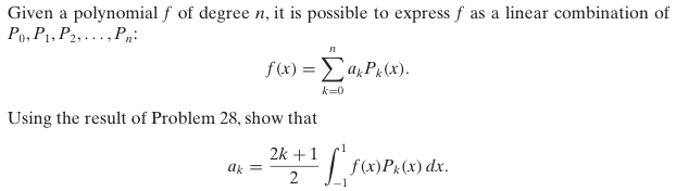

For the question attached in the file, how exactly does one go about finding a solution? Problem 28 says that if n does not equal m, then ## \int_{-1} ^{1} {P_n}{P_m} = 0 ##
With that statement, I've tried treating this as a Taylor series (centred at 0, arbitrarily) and then trying to find a general term that would allow me to isolate for ## a_k ## but that was unsuccessful.
Since ## P_k (x) ## and ## f(x) ## have similar orders, can I assume ## \int_{-1} ^{1} {P_k (x)}{f(x)} = 0 ##? This doesn't really help, unless I want the trivial solution for ## a_k = 0##
I also tried substituting the ##a_k## term into the sum to show the two sides are equivalent, but end up with ## f(x) = \sum [{P_k} \int_{-1} ^{1}f(x){P_k}(x)]## but I can't quite do anything with this either.
I just don't quite see how the above statement from Problem 28 is useful in this problem, and am uncertain on how to proceed. Any hints or explanations would be greatly appreciated!

It may be easier to see if I adjust the notation a tad:
You have (1) ##f(x)=\sum_{n=0}^N a_nP_n(x)##, and (2) ##\int_{-1}^1 P_nP_m\;dx = 0:n\neq m## (wat happens for n=m?)
Your task is to find the kth coefficient in (1) exploiting the property in (2). (Do you know anything else about P?)
Note: ##\int_{-1}^1 P_k(x)f(x)\;dx \neq 0##

Ok, thank you for the feedback! I did this:
Multiply both sides by ## P_n (x) ## to get:
## P_n (x) f(x)= P_n (x) \sum_{n=0}^N a_nP_n(x)## Then I integrated both sides wrt x, from -1 to 1.
## \int _{-1} ^1 P_n (x) f(x)= \int _{-1} ^1 P_n (x) dx \sum_{n=0}^N a_nP_n(x)##
## \int _{-1} ^1 P_n (x) f(x)= \sum_{n=0}^N a_n \int _{-1} ^1 P_n (x)P_n(x) dx ##
## \int _{-1} ^1 P_n (x) f(x)= \sum_{n=0}^N [\frac {2}{2n+1}a_n]##
But I want to find value for the general ##a_n## term, not for the sum of n terms of a up to n. How exactly do I cancel out the sum to find the general term? Have I done anything incorrect so far?
You want:
$$\int_{-1}^1 P_k(x)f(x)\;dx = \sum_{n=0}^N a_n \int_{-1}^1 P_k(x)P_n(x)\;dx$$ ... which is why I asked about what happens when n=k.

Hmmm..okay. I know that ## \int_{-1}^1 P_k(x)P_n(x)dx = \frac {2}{2n+1}## for ## k = n ##, but from here (I may just be missing something extremely obvious) I am a little lost. I can't seem to separate the ## \sum_{n=0}^N \frac {2}{2n+1}a_n ## and isolate for simply ##a_n## in ##\int_{-1}^1 P_k(x)f(x)\;dx = \sum_{n=0}^N \frac {2}{2n+1}a_n## . I just don't quite see how to break up the series and find the general expression for an arbitrary a term. Any hints?
I know that ##\int_{-1}^1 P_kP_n\;dx = \frac{2}{2n+1}## for k=n ...
... you've got it back to front.
In the equation it is n that varies and k that is fixed. What happens when n=k in the sum?
$$\int_{-1}^1 P_kf(x)\;dx \neq \sum_{n=0}^N \frac{2}{2n+1}a_n$$ ... the step right before that one was wrong.
Go back to the last equation I posted and get rid of the summation symbol on the RHS by expanding it explicitly into each term.
What happens to all the terms where ##n\neq k##?

Would the correct steps be:
## \int _{-1} ^1 P_k (x) f(x)= \sum_{n=0}^N a_n \int _{-1} ^1 P_n (x)P_k(x) dx ##
Then for k = n
## \int _{-1} ^1 P_k (x) f(x)= a_k \frac{2}{2k+1} ## which is the answer since the integral terms become 0 when ## m \neq n ##. Thank you so much for the help!
No, we do not need to consider that for ##n\neq k## that ##a_n=0## ... why would you need to?
Anyway - that would invalidate the proof.
By picking the value of k, you are choosing to evaluate the coefficient of a single term in the sum.
The point of premultiplying by ##P_k## was to isolate that term.

Yes. Sorry, I saw what you were saying now. Thank you! I just want to clarify one step still, since I don't quite grasp how exactly integrals and sums are still combined.
For this step:
## \int _{-1} ^1 P_k (x) f(x)\ dx= \int _{-1} ^1 P_k (x) \sum_{n=0}^N a_nP_n(x)\ dx##
to
## \int _{-1} ^1 P_k (x) f(x)\ dx= \sum_{n=0}^N a_n \int _{-1} ^1 P_k (x)P_n(x)\ dx ##
How exactly is it allowed for me to push the integral in the sum? Is it because the ##a_n## terms are considered constant by integration wrt to x, and the ##P_k (x)## function is independent of n? Is what I did here valid?
