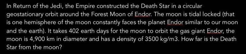

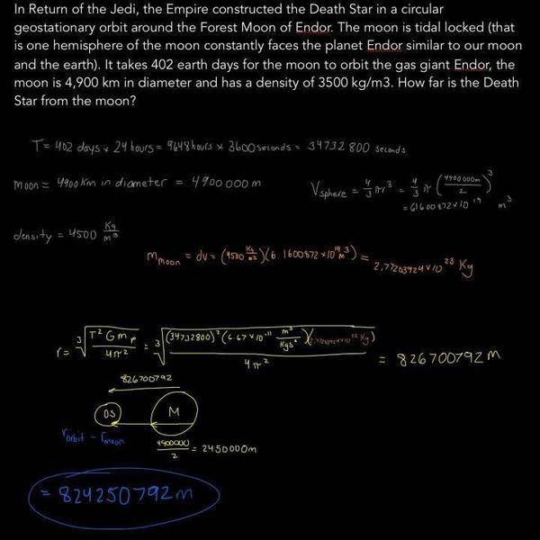

1. Homework Statement
Problem:
All known data:
Period (T) = 402 days = 34732800 seconds
Moon's Diameter = 4900 km = 4900000 m
Moon's Radius = D/2 = 2450000 m
Density Moon = 4500 kg/m3
Volume of Moon = (4/3)pi(2450000m)^2 = 61600872 * 1019 m3
r3 = (T2Gm)/(4pi2)
r = ((T2Gm)/(4pi2)) ^ (1/3)
I may have just made a math mistake, but I ran through this twice and arrived at the same result. The only thing I can think of that I may still need to do after arriving at 824250792m is somehow find the radius of the Death Star then subtract that? According to this explanation of the formula I used (http://www.dummies.com/how-to/content/how-to-calculate-the-period-and-orbiting-radius-of.html) that would not be necessary.

The density of the moon is 3500 kg/m3 according to the problem statement. You have used a density of 4500 kg/m3 for some reason.
Always check your work for silly mistakes like this. It might save points on exams and assignments.

Oops, that's not a work mistake, just a typo I forgot to check. The online program that gives the homework changes the data/values after each submission, so the problem statement has a new value of 3500, but my work is for 4500. I'm trying to correct my work, then I can start over with the new values once I figure out the correct steps to the solution.

I know it was incorrect through the submission software. Other than a math error, looking over it, the best guess I have as to why it's wrong is that I need to do one more step of subtraction. I'd need to check for other formulas to see if I have enough information, but if I could solve for diameter of the Death Star, I could then subtract the radius of it from my previous answer to get the exact distance between the moon and Death Star...

Your calculations showed an orbital radius of 826700792 m, which is 826,701 km, rounded to the nearest kilometer.
However, G = 6.67 × 10-11 is known only to 3 significant figures, which would make your orbital radius 827,000 km.
The question asks "How far is the Death Star from the moon?" That's a tad ambiguous.
The only reasonable interpretation, IMO, with the given data, is to give the center-center distance between the two bodies.

Ok, I see how those numbers adjusted to significant figures would have a pretty significant impact on the result. I will try again, making sure I'm consistent with rounding and sig figs, and find just the center to center distance without subtracting out the radius of the moon. I'll let you know if that works.

One mistake I quickly noticed was that you calculated the wrong volume for the moon.
For a sphere, V = (4/3)π ⋅ R3, but you have used V = (4/3)π ⋅ R

Wow, cannot believe I did that. That was the problem - answer accepted. Thanks for all your help!
