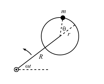

Background:
I've derived the equation of motion of the bead shown in the picture below using the Lagrangian
[tex]\omega^2Rsin(\theta)+r\ddot{\theta}=0[/tex]
The equilibrium points are at θ=0 and π. I'm now to show that only one of these points is stable.
Show that only one of the equilibrium points is stable against small deviations from equilibrium. Do so by considering small deviations [tex]\delta \theta=\theta-\theta_{equilibrium}[/tex] from equilibrium.
Rearranging the equation of motion for the acceleration [itex]\ddot{\theta}[/itex], we have [tex]\ddot{\theta}=-\frac{\omega^2R}{r}sin(\theta)[/tex]
For small angles [itex]\theta[/itex] deviating from 0, sin(θ)≈θ so the above equation becomes [itex]\ddot{theta}=-\frac{\omega^2R}{r}\theta[/itex]. Similarly for deviations from angle of π, sin(θ-π)≈θ-π and therefore [itex]\ddot{\theta}=-\frac{\omega^2R}{r}\theta--\frac{\omega^2R}{r}\pi[/itex].
The latter is larger in magnitude than the former so the acceleration with be bigger and hence it's unstable (but this doesn't really prove anything, does it?). Don't know what I'm doing here!

The whole point of this "small deviations from equilibrium" business is to obtain the equation ## \ddot x + a x = 0 ##, where ##x## is the small deviation. Then, depending on the sign of ##a##, you either get oscillations (stable) or exponential blow-up (unstable).

Well, you have equilibrium at ## \theta = \theta_e ##, then you can change variables via ## \theta = x + \theta_e ## and obtain the equations for ## x ## instead of ## \theta ##, taking into account that ## x ## is small.

How so? ## \theta_e ## is a constant, not a variable.
And where did 'a' come from in your first post?
This is whatever you get after recasting the equation in terms of ##x## and using the "small deviation" approximation.
I must've misinterpreted what you said - thought you meant make the substitution [itex]\theta=x+\theta_e[/itex] and then sub it back into [itex]\theta=\theta_e[/tex].<br /> <br /> Could you please show or direct me to an example (or where I can read up on this)?[/itex]
Take your equation and let ##\theta_e = \pi##. Then you have ## \omega^2 R \sin (x + \pi) = r \ddot x ##. All that you have to do is approximate the left hand side with something that is linear in ## x ## (remember, x is assumed to be small).
