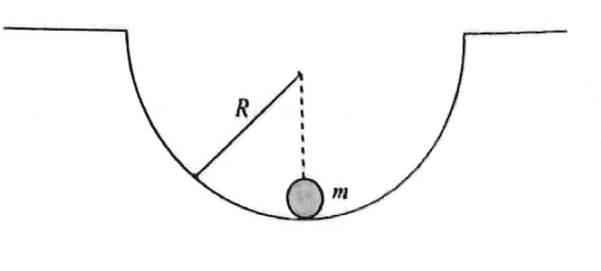

A ball of mass m and radius r is put on a smooth surface having radius R (R > r). The ball is given a small displacement and then released so that it moves back and forth at the bottom of the surface. What is the angular frequency of the ball?
a. ##\omega = \sqrt{\frac{2g}{R}}##
b. ##\omega = \sqrt{\frac{g}{r}}##
c. ##\omega = \sqrt{\frac{g}{R}}##
d. ##\omega = \sqrt{\frac{g}{R-r}}##
e. ##\omega = \sqrt{\frac{g}{R+r}}##
Restoring force = m.a
Small angle approximation
##a=- \omega^{2} x##
Diagram of a small ball of mass m resting at the lowest point of a smooth circular bowl of radius R, with a dashed vertical line from the centre of the arc down to the ball.
When given a small displacement ##x##, the equation for m is:
(i) N sin θ = m.a where N is the normal force acting on the ball and θ is angle of the ball with respect to vertical.
(ii) N cos θ = m.g
So:
$$\tan \theta = \frac a g$$
$$\frac x R = \frac{\omega^{2} x}{g} \rightarrow \omega = \sqrt \frac{g}{R}$$
Is this correct? The size of m is not important?

You have not defined r, but supposing it is the radius of the ball, what is the path of the ball’s center of mass?

r has been defined by the question as the radius of the ball.
When given small displacement, the path of the ball's center of mass is arc of circle? Is this what you mean?

Of what radius?

Ahh I see. The radius of the path is R - r so the answer should be (D).
Since ##\omega## can only depend on g, r, R and m, dimensional analysis shows that m is irrelevant.

I tried to use torque equation when solving the problem, yet the result differs significantly from the result when using translational method...

Not unless you show us what you actually did.

$$-mgsin\theta(R-r)= I\ddot\theta$$
Since ##\theta## is small, and ##I = 2mr²/5 + m(R-r)²##:
$$-mg\theta(R-r)=[2mr²/5 + m(R-r)²] \ddot\theta$$
From the above equation, it is clear that it is different from the translational:
$$-mgsin\theta = m\ddot\theta (R-r)$$
This equation is not set up correctly. It says that when the CoM of the sphere has an angular displacement of ##\theta##, the rolling sphere rotates by the same ##\theta## about its center. It does not. It rotates by a different angle ##\phi##. In other words, the orbital angular momentum of the sphere is ##L_{\text{orb}}=m(R-r)^2\dot {\theta}## and the spin angular momentum is ##L_{\text{spin}}=\frac{2}{5}mr^2\dot {\phi}##. You need to find the constraint relation between ##\theta## and ##\phi.##

In the problem of post #1 there is no friction, so no torque about the ball's centre. It will not rotate. The moment of inertia is irrelevant.

Ah. Sinc it is not spinning, ##\dot \phi## is 0. Is this true?
Correct. I thought you were doing the spinning problem.
