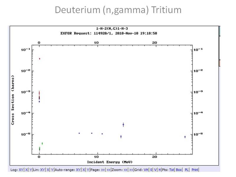

If we bombard a gas or plasma of Deuterium with Neutrons will they "stick" and from Tritium?
Not too likely. Heavy water reactors use the fact that the probability of this reaction is 0.
Some will, but you need lots of neutrons (thermalized)... The vast majority will be lost by other paths, which is why the CANDU reactors use D2O as a moderator.
Deuterium's absorption cross section for thermal neutrons is .52 millibarns
from: http://en.wikipedia.org/wiki/Heavy_water
Here is a plot of the high energy deuterium (neutron,gamma) tritium cross section from the "Barn Book" series data sets at
http://www.nndc.bnl.gov/atlas/.
Looks like about 10 to 20 microbarns high energy neutron capture cross section at 14.1 MeV neutron energy from D-T reaction.

I see.
It appears our target it just to small, making the probability infinitesimal.
I understand why the tritium breeding methods using lithium 6 and 7 is preferred now.
