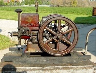

Flywheels are used for short-term energy storage, like on the one-cylinder hit-and-miss farm engine, which had to coast for 720 degrees (somethimes more) between spark ignition. See thumbnail. For four-clinder automobile engines, a flywheel makes the idle RPM smoother.
(picture taken from http://cgi.ebay.com/ws/eBayISAPI.dll?ViewItem&item=400085029474 )
Bob S
